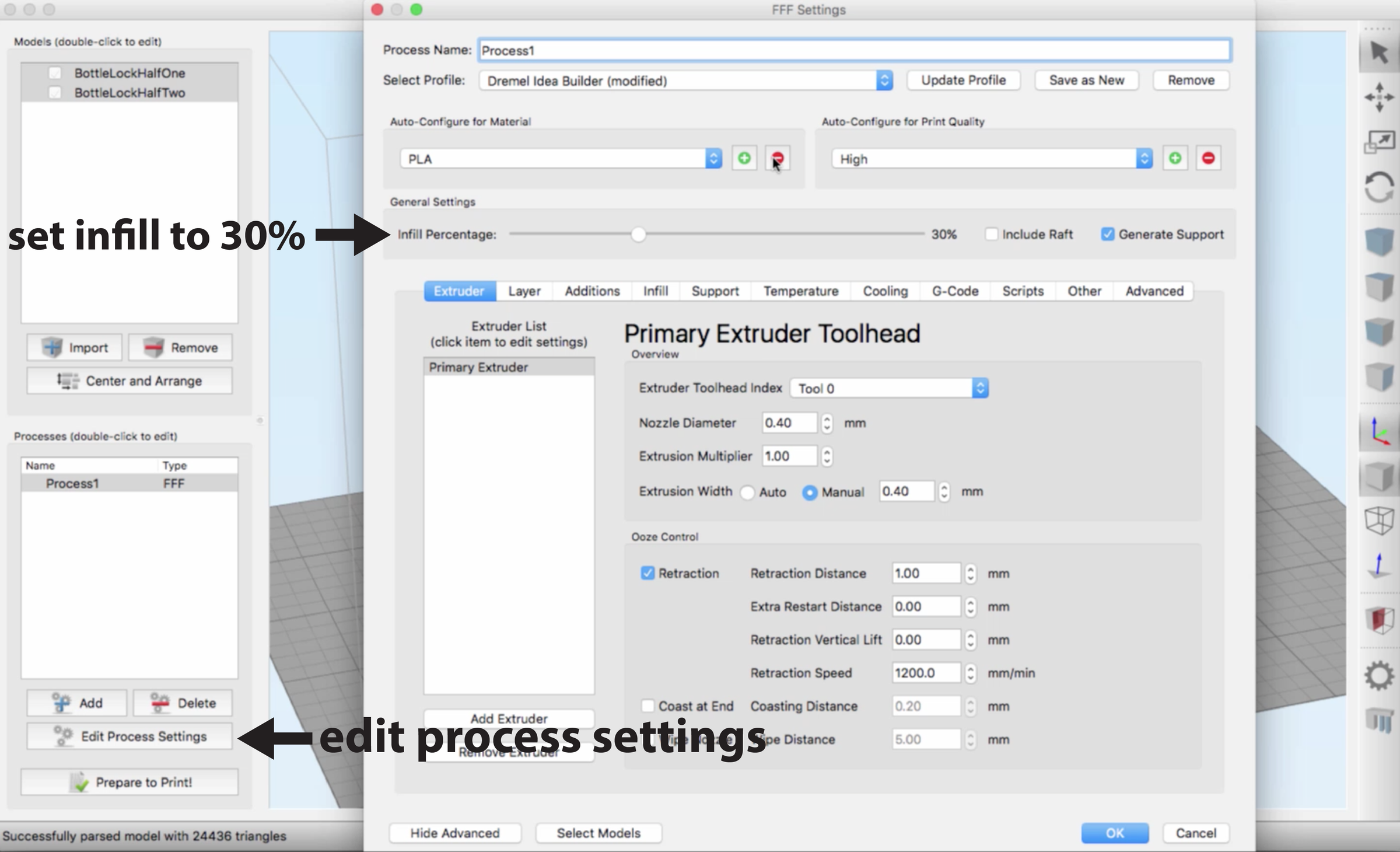

Edit Process Settings > Set Infill Percentage to 30%
In Edit Process Settings, you set the 3D Printer Model (Dremel Idea Builder for me). There is a bewildering array of options here, but all you really need to do is set your Infill Percentage (30% in plenty for almost any project), and click the Generate Support checkbox.

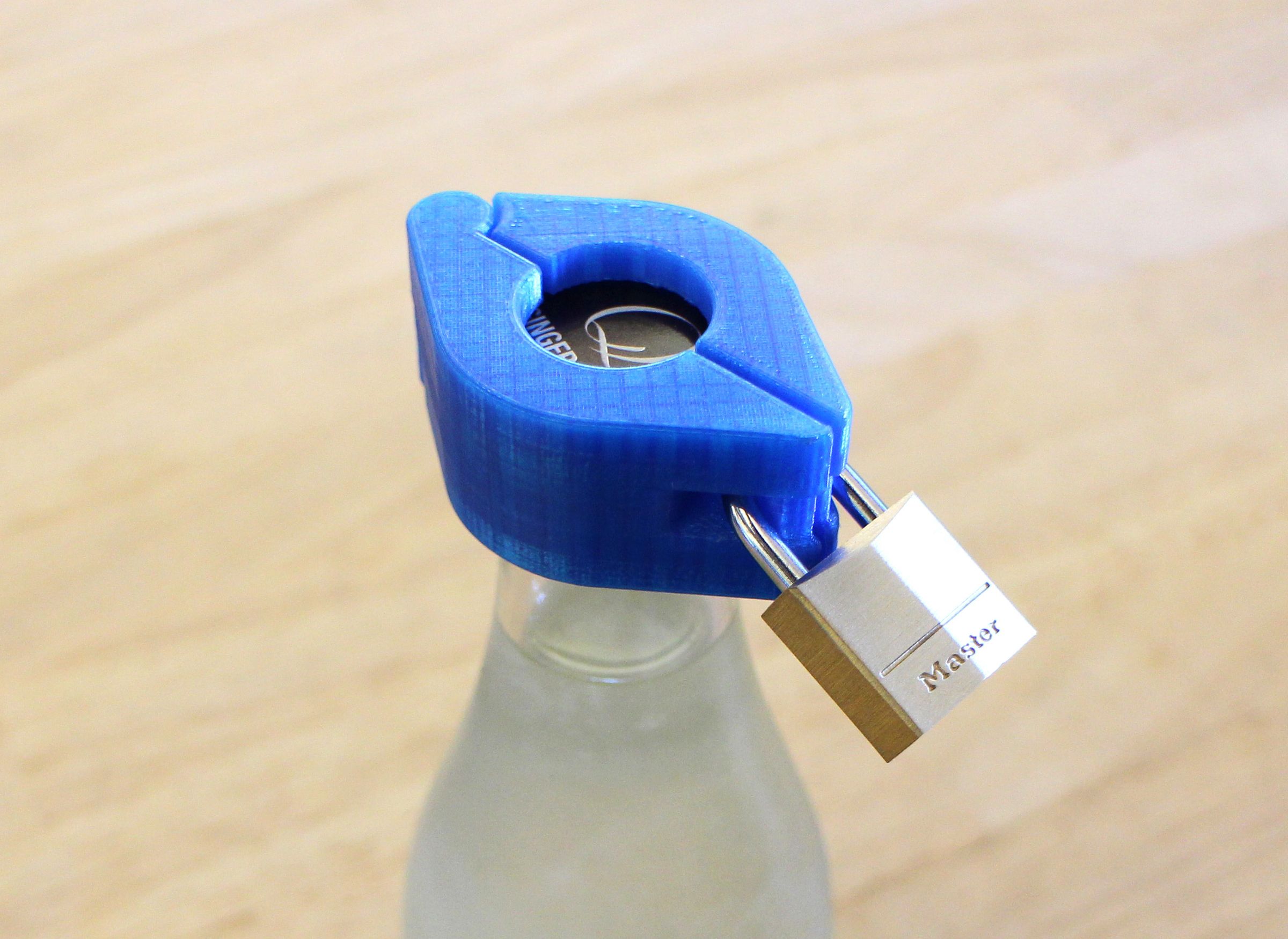

Printed!
With the files exported to the SD card, all we have to do is refer to the Setup and Print Lesson and print out the Bottle Lock. With the proper settings, Simplify 3D gives us a flawless print as long as the printer doesn't run into any snags.
The support structures snap off effortlessly- parts might need a little minor cleanup.
