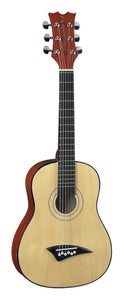

A few years ago I looked at my old mini starter guitar sitting in the corner, and I decided I wanted to mod it. I found some inspiration from Instructables, and decided I wanted to change the body shape, resurface it, and scallop out the frets. This ended up being a much bigger project than I first thought. I started out wanting to repaint the guitar, but then I found artist in Colorado who glued flattened bottlecaps over things like chairs and tables. I was inspired by this, and decided that I would do the same. The artist flattened bottlecaps so that the edges were splayed out around the outside, then he layered them like scales. At first the only way I could flatten them was with the edges folded under, by hammering the top while the cap was on a flat surface. Later, I found the way the artist did it, by setting the bottlecap upside down on a surface and hammering. I decided I would just continue with what I had started. Some bottlecaps didn't hammer as neat as others, but I thought it gave the surface nice variation.

This was my second step, and I did this by drilling starter holes and sawing using a hacksaw blade. This was not very efficient, but I wasn't sure what other saw to use, and I wanted to be as accurate as possible. After I had made the two cuts, I used pieces of sheet metal to cover the holes, because as a novice woodworker, I wasn't ready to bend wood pieces to fit the shapes. I glued the sheet metal in place with gorilla glue, and sanded afterwards to clean up the excess. I also cut off the top of the head, just cause I felt like I needed to change it.
