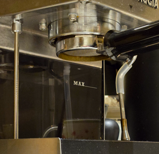

Introduction: Bottomless Portafilter Conversion for Gaggia Classic
How to convert an old Gaggia Classic portafilter to a bottomless one.

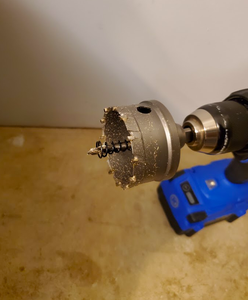

  1. 60 mm OD hole saw and suitable drill
  2. Piece of scrap wood
  3. Wood screws
Step 1:
Mount the portafilter on a piece of scrap wood, level it with a screw. Make sure it doesn't move, mounted as tight as possible.
Step 2:
Carefully drill out the bottom using the circular saw. Make sure the pilot drill hits exact center of the portafilter bottom. Apply finishing touches with a file.
