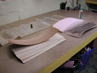

Vacuum laminating is ideally suited for creating curved surfaces. Traditionally with vacuum bagging systems, a curved wooden mold to shape the lamination had to be built. A new (and simple) way to do this is to build a mold with insulation foam available at most building supply outlets. The foam makes it possible to quickly create a 3 dimensional curve using basic tools.

Thin Air Press Vacuum Bag Kit (14" x 47" bag plus kit parts, breather netting, sealing tape, pump)
Materials Needed:
2" Thick Foam Slab
Laminating Materials - such as 1/16″ veneer, Luan 1/18″ door skin, even tempered masonite has proven sucessful
Glue
Masonite or heavy card material to make a template
Plywood Substrate
Sanding Block

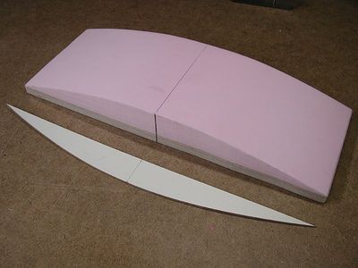

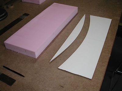

I cut my template out of masonite. When doing this be very accurate, making sure that the template is the exact curve of the inside circumference of your drawer. The template should have a very accurate center line drawn on it. Make the mold convex in shape, as it is much easier for a vacuum bag system to wrap veneers over a convex shape than to pull them down into a concave shape.

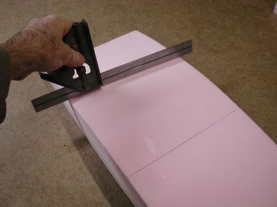

When cutting out the rectangle of foam, make it slightly larger than your final drawer size in both the length and width. The veneers should not overhang the mold while laminating. Make sure the width of the foam is parallel and the ends are square. Draw a center line across the face of the foam and down the two sides as shown below.
Draw a single line using the template on either side of the foam rectangle. Use the center line to align the template as this will help to ensure the line is parallel on either side of the foam.
Step 2: Shaping Foam Mold

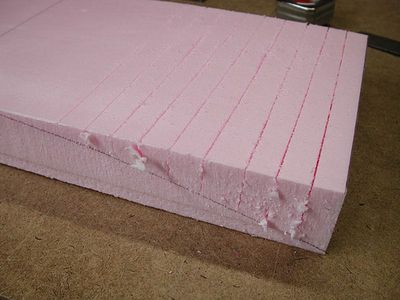

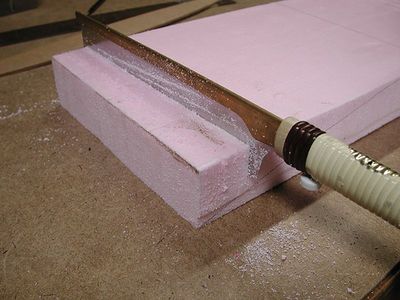

Now because my bandsaw is not wide enough to cut the profile out, I am going to use a backsaw. Make a series of cuts around 1″ apart across the foam. Cut down almost to where your template line begins. Do this on both ends of the foam.

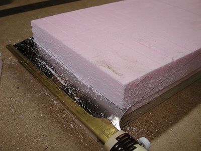

Using the backsaw turned sideways, cut through each of the vertical cuts. Do not cut below the template line. Repeat this on either end of your foam. What you will end up with is a chunky looking surface. Do not worry about this as the next step will make it look better.

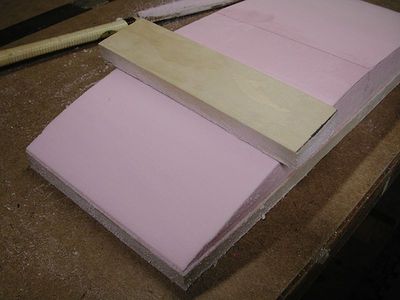

Because my foam looks like it is going to get pretty thin at either end of the mold, I cut a piece of 3/4 plywood the same size as the foam. I glued this to the bottom using a woodworker’s glue or spray adhesive. You can see this addition to the foam in the picture below. This will also prevent the ends from distorting in the vacuum bag while trying to bend multiple layers of veneer.

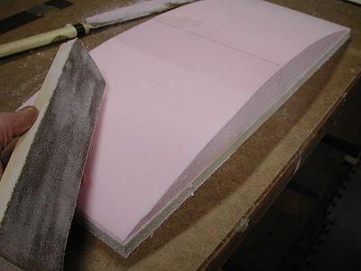

Now you can smooth out the foam mold to its final shape.
I made a sanding block out of a piece of wood by gluing 100 grit sandpaper to one face. The block should be wider than the mold. This is what I used to smooth down the roughed-out foam mold.
Using the block, sand across the mold taking care not to sand below the template line on either side of the mold. The sand paper is quite aggressive so be careful not to get carried away. Do not sand along the mold lengthwise as this can cause a hollow in the foam that cannot be fixed.
Here is a great way to check how flat your mold is - Using a straight edge, hold it across the face of your mold. If there is a gap at the ends between the ruler and foam, you will need to sand a bit more across the middle of the mold.

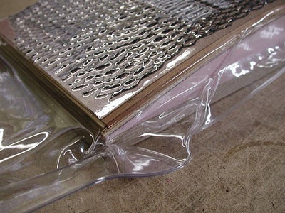

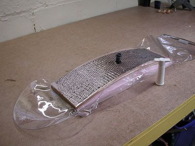

Apply a piece of masking tape to either side of the stack at the top crown of your drawer face. This will help to keep the veneers aligned while putting them in the vacuum bag. Place the veneers on top of the foam mold. You may also want to masking tape the stack to the mold by placing a length of tape across the center and down either side of the mold. Lay a piece of pre-cut breather netting on top of the veneer to allow for even evacuation of the air from the TAP bag. Carefully place the stack inside the vacuum bag. Peel the paper from the sealing tape and pull firmly on either side of the TAP bag to stretch the bag flat against the sealing tape. With your finger, carefully press the sealing tape to the vinyl TAP bag working from the inside of the bag towards the outside. Look for any light colored areas where the tape is not firmly pressed down. These will be visible and only need a little thumb pressure to remove them.
Now press the pump against the grey one-way valve and remove the air from the TAP bag. Because the form inside the bag is fairly flat, it should take less than one minute of vigorous pumping using the TAP kit’s manual vacuum pump. You have achieved maximum vacuum when you feel the handle on the pump hard to pull and you can not pull the vinyl away from your project. This will create over 13 lbs per square inch. With a project this size, there will be over 2000 pounds of pressure evenly pressing down on your veneers. This is more than enough pressure to press any veneered project.
In a few minutes, check to see if you have any leaks along your sealing tape by pulling at the edge of the vinyl. If the vinyl pulls away from your project, look at the sealing tape for any light colored areas and use your thumb to press these out. Once done, you can re-pump your TAP bag.
The process is very simple and if you follow the basic instructions, the TAP bag will maintain vacuum for as long as it takes your glue to dry. I leave a project like this in the TAP bag for at least 8 hours.

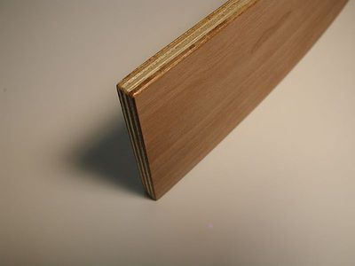

Once you remove your drawer face from the TAP bag you will have to square up the edges using either a hand plane or jointer. I used a jointer on one edge of my drawer face before going on to the table saw to cut them down to final size. The last step was to sand each of the drawers faces and apply finish.

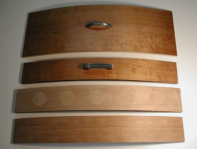

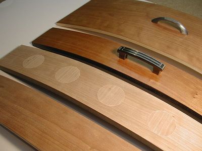

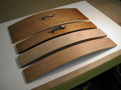

Here are some of the drawer faces I have made in the TAP bag using a number of different laminating materials.
Building the foam mold took around 2 hours as I had to be careful to get it right. Cutting and laminating the individual drawer faces took about an hour. The foam mold stood up to repeated use. I am sure you would have no problem making a least dozen drawer faces from the same mold!
I think the results of this build look great and are well within the skill level of most woodworkers.
