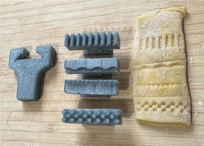

Creating your Pasta Edge Textures:

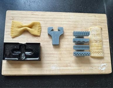

Located on the bottom of the BowTie Buddy are marking tools to create patterns and that ‘professional’ look that all home chefs are looking for. To make your own edge textures for the ends of the dough, you can create simple patterns that make your pasta unique to you! I included a bunch of examples that you can create & experiment with to customize your pasta, along with a fork tool where you can create your patterns and quickly print them out.
  1. Fork lines
  2. Triangle Points
  3. Smooth Waves
  4. Knurled Grooves
Changing Thickness:
Bowtie pasta can be amazing at many different thicknesses, mostly up to personal taste. To change the thickness of the cut on the BowTie Buddy, simply add or remove height from the side cutting tool.

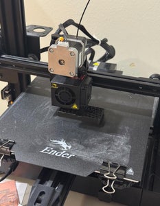

Step 2: Printing Your Bowtie Buddy
Using a food-safe filament is ideal, however, any filament is adequate for printing because of the sealing process, but I recommend printing the files on 50 % infill with a brim or raft to prevent warping.

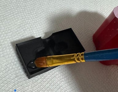

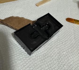

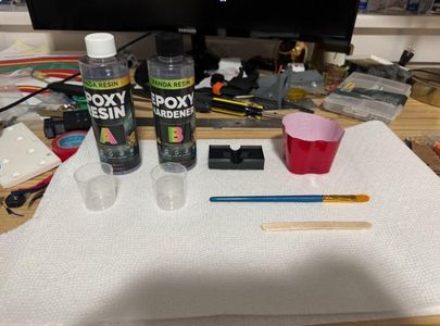

Step 3: Applying Epoxy
FDM 3D printing is incredible for developing quick functional prototypes with unlimited possibilities. Unfortunately, there are certain limitations to what you should make with 3D printing. Oftentimes, it is discouraged to create food-related tools with 3D printing, but simply using food-safe epoxy resin to fill in the small gaps between layers can make your BowTie buddy safe to use in your kitchen. Additionally, because all pasta dough will be boiled before eating, this is just an extra precaution for your pasta.
For more information on why 3D printing with food can be a problem, see this source: https://www.makeuseof.com/are-3d-printed-utensils-food-safe/

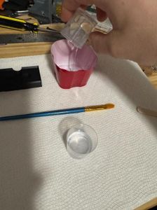

See your epoxy for differences in instructions, but for the most part, it should be relatively similar:
  1. Put on latex gloves if desired.
  2. Mix specified volues of your resin and hardener into a disposable cup
  3. Stir for 3 minutes, making sure to go along the walls and floor to mix all parts of the container
  4. Take a paint brush and apply a layer across the surface of the BowTie Buddy
  5. Leave for 24 hours while the resin cures

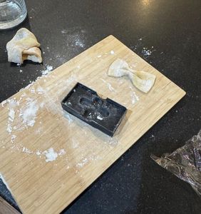

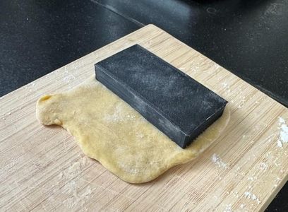

Step 5: Using the BowTie Buddy
The BowTie Buddy is easy and (I would say) fun to use. Once you have properly prepared your sheet of dough, you are ready to stamp out your bowties.
  1. Place the BowTie Buddy in a piece of dough large enough to cover all edges.
  2. Press down and wiggle left and right just like a cookie cutter.
  3. Remove the piece of dough and place it within the cutting side of the BowTie Buddy.
  4. With one finger pushing into the center of the pasta, pinch on both sides and remove from the tool.
  5. (Optional) At this point, your pasta is fully shaped and ready to cook. If you want to add a flare of personality or fanciness, stamp the pasta edges with your patterns to create a unique look.
