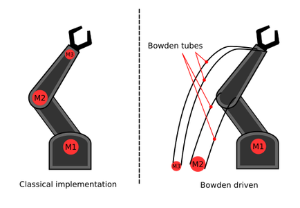

Step 1: Overview

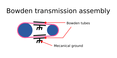

This concept uses 2 low friction Bowden tubes (PTFE) allowing to route a belt in any shapes, contrary to classical motors+belt assemblies, this solution provides great flexibility (pun intended) on the position of the motor relative to the end effector, indeed in a classical belt and pulley implementation, the axis of rotation of the motor is usually parallel to the axis of rotation of the end effector. In addition, if an end effector has multiple degrees of freedom (think robot hands, robot dog legs, etc.), the motors are usually mounted on one of the moving part (for example, in a humanoid robot the wrist moves with motors are usually mounted on the forearm assembly which in turn is moved with the elbow assembly etc) increasing the weight of the moving part of the mechanism. Using Bowden tubes, you could have all motors static and Bowden tubes to the different joint. This makes for a lighter robot or rather for a lighter moving mechanical assembly (all the motor are static in this example).

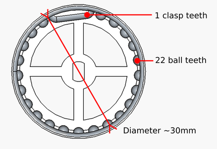

On challenge of using those cheap steel beads chains is that they are quite short and the clasp makes the beads chain not ideal to be belt driven. In order to accommodate for this, I chose a number of beads in between 2 clasps I call this my « chain element ». As long as I account for the clasp in the wheel design it works fine. It should be noted that if the belt skips, then I will have trouble driving the belt, it is one of the main challenge, the belt has to be « in phase » with the wheels.

As previously explained, the motor are placed away from the end effector making for a more flexible mechanical system . By that I mean that the motor can now be placed wherever there is still space (in a robot for example)

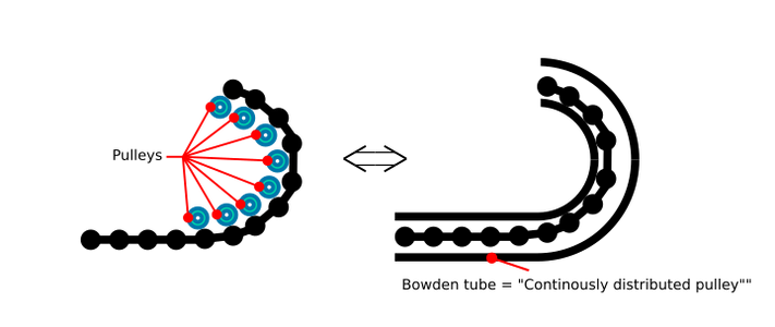

Step 4: The "Continously Distributed Pulley"
In a classical belt or cable system, there are usually tensioning pulleys in order to tighten the belt or cable. In my implementation, I can coarsely tune the length of the total belt by choosing the number of chain element (think of it as a coarse digital tuning) and then I adjust the tension by moving the tensionner relative to the motor (fine analog tuning). When tensionning the chain is pressed on the side of the PTFE Bowden tube showing once again that the choice of material for the belt and for the Bowden tube is very important. One interesting thing to note is that the Bowden tube works as if there was a lot of tiny pulley on the side guiding the belt. I call this the « Continuously distributed pulley effect »
