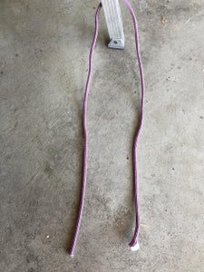

  • Rope
  • Something to be anchored to the rope (that's the metal leg you see in top of picture)

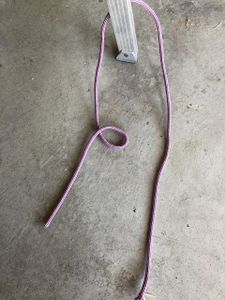

Step 1: Make Overhand Quarter-Size Hole in Shape of a "6"
This is the hardest part to remember:
Make an OVERHAND hole, looks like a 6 or a P.
If you can get this step right, the remaining steps are easy.
As a mnemonic: A bowlin' (BOWLINE) snake throwing the ball OVERHAND and carrying a SIX pack.

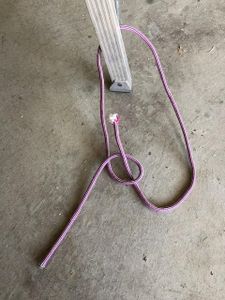

Step 2: Snake Comes Up Out of Hole
Now the traditional bowline mnemonic story goes on. Pretend the loose end is a snake or a rabbit. The quarter-sized hole is the uh... hole.

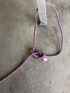

Step 3: Goes Around the Tree
By 'tree', they mean the opposite vertical part of the rope, not the actual thing that you are anchoring down to. Sorry, this is why I tried not to add too much narrative.
Step 4: And Back Into the Hole

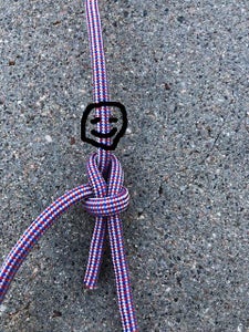

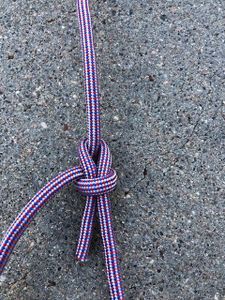

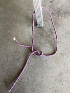

Step 5: Looks Kind of Like Someone in a Life Jacket
A clean bowline looks symmetrical and kind of like Gumby (or someone with a long head) in a life jacket.
