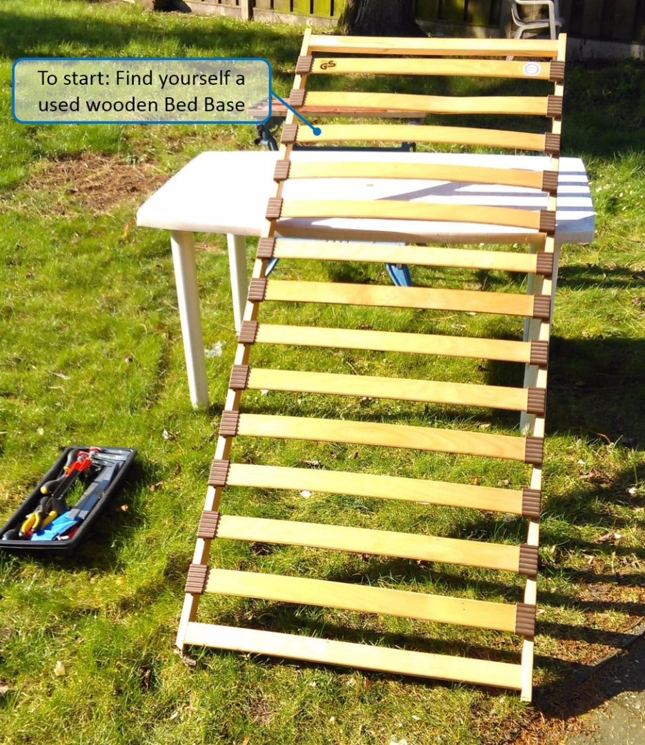

While upgrading a bedroom I ended up with an old wooden bed base that has 2 broken boards. I decided to transform it into a nice looking storage box. A typical project in which I try to use as much re-purposed materials as possible.
So if you happen to come across a spare wooden bed base, don't throw it out but transform it to something useful.
Step 1: Dis-assembly
To be able to start building you need to get your building materials. That means the bed base has to be fully disassembled.
The tool I used for this step:
- Screwdriver
- Claw hammer
- Pliers
1. Start by removing the screws. Make sure to save them, they can be re-used later in the project!
2. After removing the screws all the wooden boards should fall right out.
3. The plastic end-caps remain, they are a bit harder to remove since they are nailed to the wood. I wiggled them of with the claw of a hammer.
4. If some of the nails remain in the wood, they can be pulled out using pliers.
All done, now you have your stack of building materials ready! Make sure to dispose of the plastic parts and the nails appropriately.
