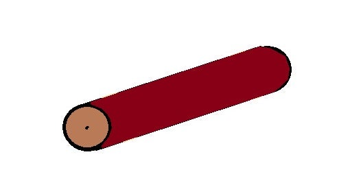

PIC1: I used an PVC outlet pipe what that was 100 cm long and cut it to fit 90 cm.

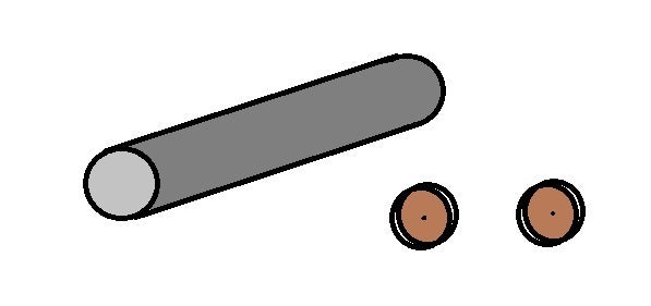

After that i cutted out 2 slices of wood that perfectly fitted in to the pipe (diameter 150)
PIC2: then i screwed Pipe and sclices together and in the slices i drill a center hole

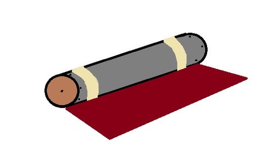

PIC3: I used doublesided tape and taped it around the pipe one at both ends and one in the middle
PIC 4+5: Then I used some paper tissue and rolled the pipe over the tissue

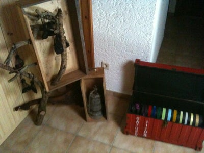

PIC: 6 I measured the perfect mid of the box, drilled a hole on both sides and screwed the pipe in to the box, so i could still turn the pipe, but was still fixed properly
