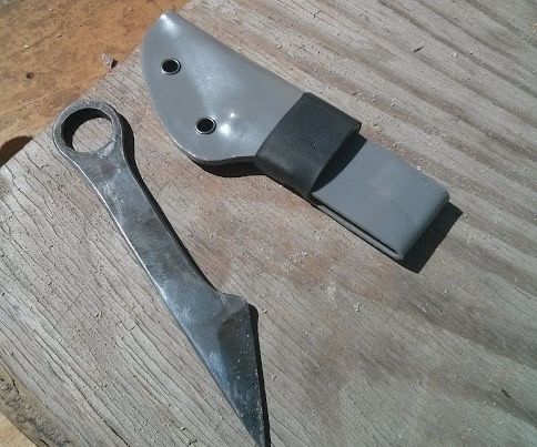

- Marking knife
Tea bags have a habit of moving around a lot if there is too much space for them to move, so I wanted to add some dividers.
I still had some cutoffs left which were not glued. I cut 2 pieces long enough to fit halfway into the sides of the box, cut them halfway through and made a cross section. Then I took a smaller cutoff scrap and measured/marked where they would inset into the side of the box. I used a marking knife in combination with a small chisel to cut away the slots for the dividers.
