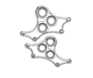

Wile designing this shelf, my goal was, to create an unique example of using the belt friction for holding an item on a wire rope.
The *.stl files witch are provided fits with an box with an depth of 10.8cm. But you can also design your own side parts witch fits to your box.

Step 1: 3d Print the Side Parts
If you have access to a 3d printer, you can printout these side parts. If not, you can print them via someone from the 3D-Hubs community.

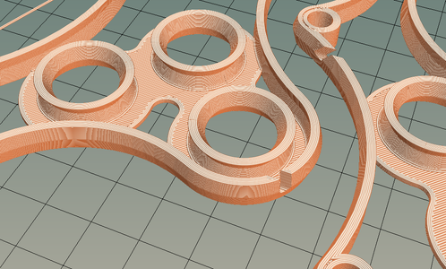

This parts are easy to print and don's need any support. But i recommend to have the following detail in mind wile slicing the model for 3D-printing.
The parts are designed with a constant wall thickness of 1.8mm. If you choose a extrusion with of 0.3mm the printer will make six perimeters for each wall.

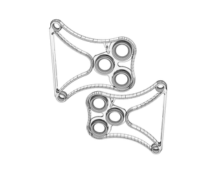

Step 3: Assemble the Box Shelf
Now we can assemble each single box shelf.
Depending on the print quality you have to rework the holes with a drill an a countersink.
Now you can simple press the wooden sticks in to the holes of the printed side parts of the shelf.
If the fit is tight you will need a hammer. If it is loose try it with some glue. (3D-prints and wooden sticks are both not very precise.)

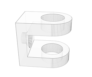

Step 4: 3d Printing Wall Fixture
If you need this wall fixture depends on the way you can hang up the wire rope.
This wall fixture is designed similar to the side parts of the box shelf. It prints also in the same way.
You also need two of these small brackets witch you can screw into the wall.

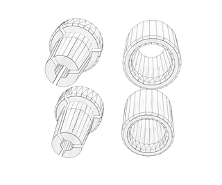

Finally there is a wire rope clamp i designed for an other project. You will also need two of thous for securing the upper end of the wire rope. You can see how they work in the video.
