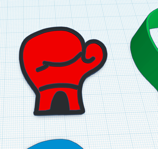

Step 2: Scribble an Image
Start a new Scribble. The Scribble function is available in the Basic Shapes drawer on the right side of the TinkerCAD UI. Draw a basic line drawing. In my case I made a simple boxing glove. This can be exact or rough. Mine was rough, just using my finger on my laptop touch screen from a reference picture.
Once you're satisfied with your drawing, make your scribble into a 1mm thick solid floating 2mm off the build plane. This will be the image on the top of your box lid.
Copy and paste this scribble onto the build plane.
Step 3: Fill in Your Scribble to Create a Background
Take the copy of your image and edit it again in the scribble tool. This time, fill it in completely as a solid shape.
Extrude this scribble as a 1mm thick solid, this time 1mm above the build surface. This is your background.

Take the image scribble and place it directly on top of one of the background scribbles. make sure they line up exactly by zooming in from different angles and checking the edge alignment. If the edges don't align, the best method is to switch the snap grid to 0.1mm and use the arrow keys to gradually scoot the pieces around until they match. Once the image is perfectly aligned on the background, group the two pieces together.
