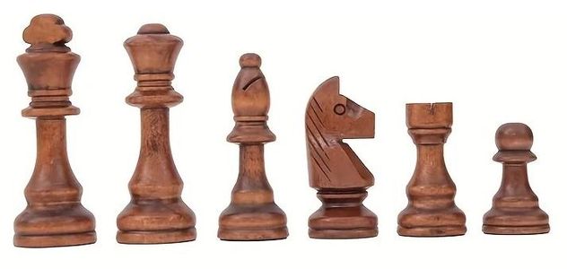

Step 2: Transforming Chess Figure SET to BRAILLE Chess RULE 1
Since I didn't have any Chess set at home I had to order. If you have a chess set at home, you can use it. Make sure is wood since the material is so much easy to work with. Any mistakes can be easily repaired with some Epoxy Resin.
The black side has to be BRAILLE marked. Chess for the visually impaired does not need letters. The markings are raised black squares and Pointy tips on the black set of figures. Figures also need bottom plugs. They help the visually impaired to properly position Figures on the chessboard. ALL 64 fields have holes in the center to plug the figure in.
On the TOP I used a 2 mm drill bit to make 5 mm depth holes. I used Dart tips, cut them 1 cm at the top, and pushed them inside each black figure TOP.
Step 1 DONE.
Step 3: Transforming Chess Figure SET to BRAILLE Chess RULE 2
At the bottom, I used a 5 mm width wood stick and cut it to a 1 cm long roller. The hole on the bottom is 5 mm deep. If you don't mind the looks you can also use shelf holders which are made of nylon.
If you drill a hole too deep. Don't worry. You can use epoxy and dip the 1 cm wood roller into and push into the hole on the bottom.
The final step is to sand on the bottom so the Chess figure is easily inserted into the Chess Board. You can DIP them into epoxy again to protect the insert or Varnish them with a makeup brush. Why MAKEUP? Is Cheaper and better.
Step 2 DONE.
