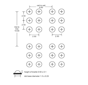

In order to design a product that converts text to braille, we first had to learn braille. I highly recommend printing out the braille alphabet using a 3d printer and practicing with the physical thing. There are many open source 3d models available online - I sourced mine from Maker World, as I use a Bambu labs printer.
We also found the standard dimensions for braille published by the UKAAF, as we had to follow these for the design of our braille display pad, ensuring it has the same proportions and feels almost the same as any other piece of braille printed in the UK.

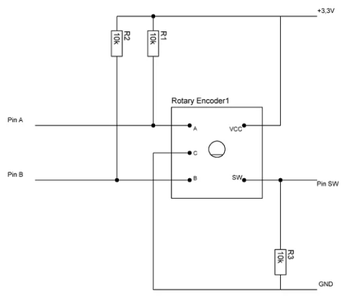

Step 5: Electronics
We first planned out the electronics by drawing some sketches and finding diagrams online. After this, we could test them on a breadboard before soldering. The circuit design we created uses MOSFETs as drivers so that the low current output of the Arduino can control the high current draw solenoids. If you want to better understand how these transistors work, I recommend watching this youtube video by the engineering mindset.
Note: One key addition that took us a while to figure out was the 1M ohm resistor between gate and ground. We found that this was the minimum resistance that worked with the IRLZ34N for us (too much current leaked through with any lower resistance resistors we tried), despite most guides recommending only 10K ohm. This might be a fluke relating to our components or setup though, so please do try a range of resistor values if 1M ohm doesn't immediately work for you.

  1. microswitch pin - 10
  2. rotary encoder pin A - 2
  3. rotary encoder pin B - 3
  4. rotary encoder switch pin - 12
  5. piezo transducer - A0

cli(); //stop interrupts happening before we read pin values
reading = PIND & 0xC; // read all eight pin values then strip away all but pinA and pinB's values
if(reading == B00001100 && aFlag) { //check that we have both pins at detent (HIGH) and that we are expecting detent on this pin's rising edge
encoderPos --; //decrement the encoder's position count
if(state>0){
state--; //moves back to the prior letter
}else{state=charArraySize; //goes to end of list if turned to before a
bFlag = 0; //reset flags for the next turn
aFlag = 0; //reset flags for the next turn
else if (reading == B00000100) bFlag = 1; //signal that we're expecting pinB to signal the transition to detent from free rotation
sei(); //restart interrupts
void PinB(){
reading = PIND & 0xC; //read all eight pin values then strip away all but pinA and pinB's values
if (reading == B00001100 && bFlag) { //check that we have both pins at detent (HIGH) and that we are expecting detent on this pin's rising edge
encoderPos ++; //increment the encoder's position count
if(state<charArraySize){
state++; //moves onto the next letter
}else{state = 0;
else if (reading == B00001000) aFlag = 1; //signal that we're expecting pinA to signal the transition to detent from free rotation
Many thanks to SimonM83 who wrote this rotary encoder instructable. I've used his code in this project.
