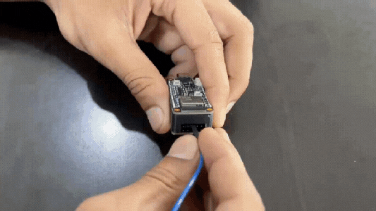

Step 4: Connecting NPG Lite
Connect the snap caples to Neuro PlayGround Lite.

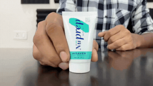

  1. Apply Nuprep Gel to each target area.
  2. Gently rub to exfoliate and remove dead skin
  3. Wipe the area clean using an alcohol swab.
It ensures minimal noise and maximum signal clarity during meditation
What is Nuprep Gel?
Nuprep is a mildly abrasive, highly conductive gel that improves electrode contact by reducing skin impedance. It's safe, effective, and causes minimal skin irritation.

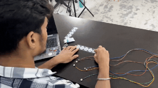

Step 6: Wearable Setup
Electrode Placement
ElectrodePlacementSignal Type
A0PCenter ForeheadEEG
A0NBehind Right EarEEG
A1P and A1NLeft Arm (biceps)EMG
A2P and A2NRight Arm (biceps)EMG
REFBehind Left EarGround

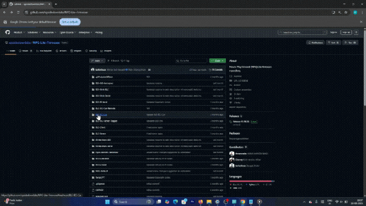

  1. Upload BLE-BCI-Car-Remote.ino.
  2. Calibrate EEG using Serial Monitor - adjust BETA_THRESHOLD if needed (Set a value slightly above your relaxed state as the threshold)
  3. Now connect the XIAO board to your laptop using the USB-C cable attached to the car, and launch the Arduino IDE.
  4. Re-upload the firmware

  2. Upload BLE-BCI-Car.ino.
