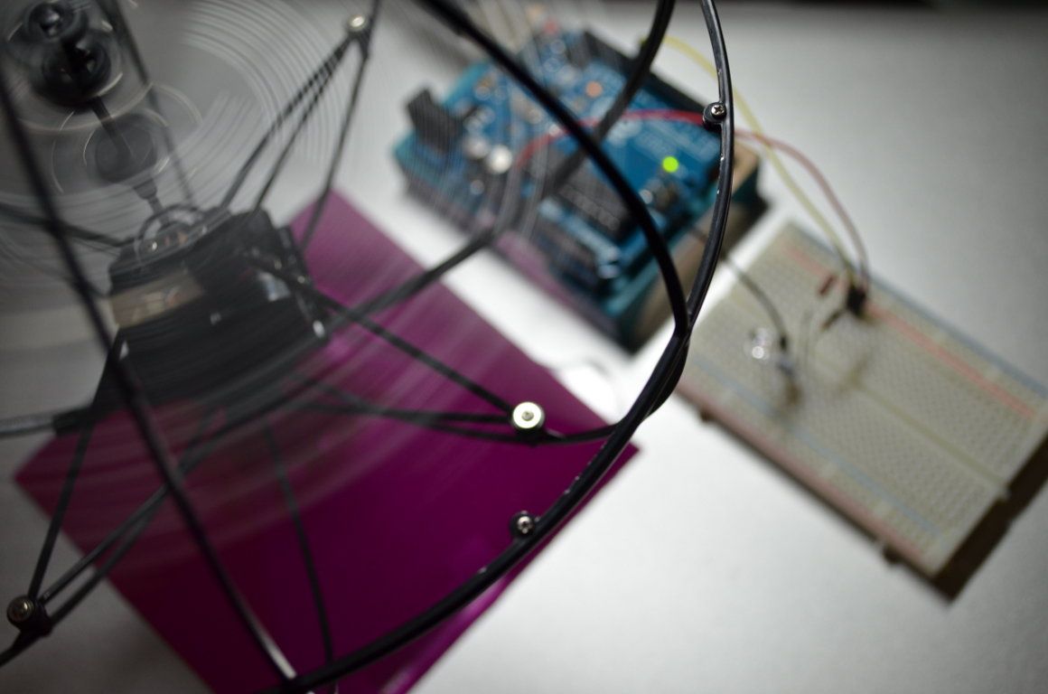

Step 8: Fly RC Helicopter Using Puzzlebox Brainstorms
Puzzlebox Brainstorms is a free, open source, cross-platform software application which permits Brain-Computer Interface (BCI) control of vehicles, devices, and toys such as LEGO Mindstorms, Radio Controlled Helicopters, and even electric wheelchairs.
In this Instructable we will use this software to fly our helicopter forward, hover, and/or land automatically based on detected levels of concentration and relaxation from an EEG headset such as the NeuroSky MindSet or Emotiv EPOC.
The first step, after loading the application, is to connect to the Puzzlebox Synapse server which was prepared in the previous step. The server can exist on the same computer system or be accessed remotely across a network or the Internet over TCP/IP. Click on the "Control Panel" tab of Puzzlebox Brainstorms and after verifying the Host and Port settings, click "Connect" to begin receiving EEG detections.
Next click on the "RC Helicopter" tab.
The transmitter chip should have already been extracted and connected to the computer system as described in earlier steps. The USB-to-Serial interface will appear as a COM port under Windows or a /dev/ttyUSB serial device under Linux. By default, when "Concentration" or "Relaxation" levels reach a certain threshold (approximately 60% or higher, specificed in the "puzzlebox_brainstorms_configration.ini" file) the "Speed" meter will begin to fill and the Radio Controlled Helicopter will take off in "Hover" mode. Once concentration or relaxation levels fall below that threshold the helicopter automatically land.
If using an Emotiv EPOC headset, you can assign arbitrary detections to helicopter functions by linking through the "EmoKey" program to the following keyboard shortcuts:
"Home" or "[" - Hover
"Page Up" or "]" - Fly Forward
"End" or "\" - Land
