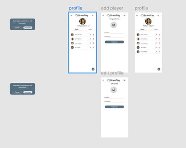

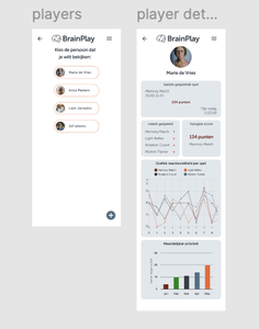

Step 4: Coding the System
Your code is split into a frontend and a backend, each with its own responsibilities.
Frontend (HTML, CSS, JavaScript)
Before coding, I recommend prototyping your interface in Figma. This will help plan layout and flow—especially useful since the UI is optimized for mobile use.
Above you’ll see my Figma design as an example.
