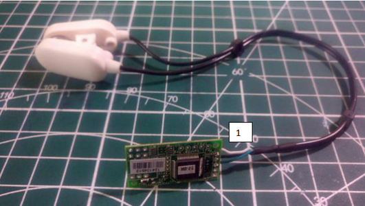

Step 2: Brainwave Acquisition Part
Now we begin to makeBrainwave acquisition part.First we need to prepare materials.
Connect like a picture.
Warning
1. Pay attention to the order of welding, according to the color from top to bottom, white line, black line and blue line. 2. Tighten the screw when fixing the dry electrode, and remove the exposed shielding wire around it, and fix it with hot glue.
3. The welding points of Tgam main board are fixed with hot melt adhesive to prevent the thread from falling off.

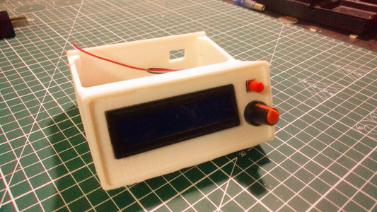

Step 4: Appearance Designappearance Design
Regarding the appearance, I suggest that you can design some good-looking shells yourself. Of course, you can also refer to my design.
1.Sketch drawing
2.3D model design
I use solidworks modeling
3.3D printing
layer height 0.02mm
fill density 20%
printing temperature 200°
Step 5: Assembly
Step 6: Explanation and Test
1. External power input, 5V to 36V external power input to the MOS module for pwm control.
2. The reset button is used to restart the display or microcontroller when the data is too large.
3. Current regulation, used to control the output of the large current.
4. Switch
5. Charging port
6. External power output
7. Microcontroller external power supply interface, 5-12v
8. Code download port
9.Elastic headband, you can use some elastic cloth to make, I take the head of the vr box down and use it here. 10.LCD1602, which shows atention and relaxation, changes every second, and when the electrode is in bad contact, the number of the display is fixed or 0.
