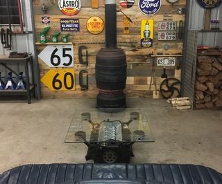

Step 13: The Performance
Here are some temperature stats that might be of interest. If there’s anything else you’d like to know that you would like covered please comment below.
At normal running the temperatures are as follows:
Flue: 210°C - 320°C (410°F - 608°F)
Top Side of Heater: 365°C - 450°C (689°F - 842°F)
Bottom Side of Heater: 550°C+ (1022°F+)
Size of Shed: 6.5m x 7.5m (21.3’ x 24.6’)
Outside Temperature: 3°C (37°F)
Inside Temperature of Shed: 42°C (108°F)
Step 14: 2 Years On
So it’s been 2 years since I made the Instructable and the heater is still going strong as ever. The paint is coming off in places as was expected being a heater I wasn’t confident it would last forever. There’s not much I’d change except making the steel grate at the bottom from something more solid than square tube as I burnt through it (granted it did take 2 years). I’ve had it glowing red a couple of times which is crazy especially considering the drum is at least 18mm thick in most places. If you have made it or have anything that you have done that’s different let me know I love to see what people make it give me further inspiration.
