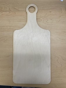

Step 5: Cut the Board
Trace the template on the board and later cut it out with a band saw.

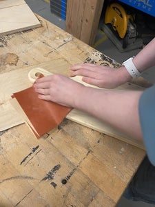

Step 6: Sand the Board
Then use any type of sander to sand the board down to make it completely flat.
If using the wide belt sander then you have to scrap off the glue before hand.
Also sand the board so that the edges are clean and smooth.
Step 7: Drill a Hole in the Handle
Drill a hole in the handle using a drill press.
Step 8: Smooth Edges
Use the router to smooth the edges completely then sand it manually to smooth it out.
