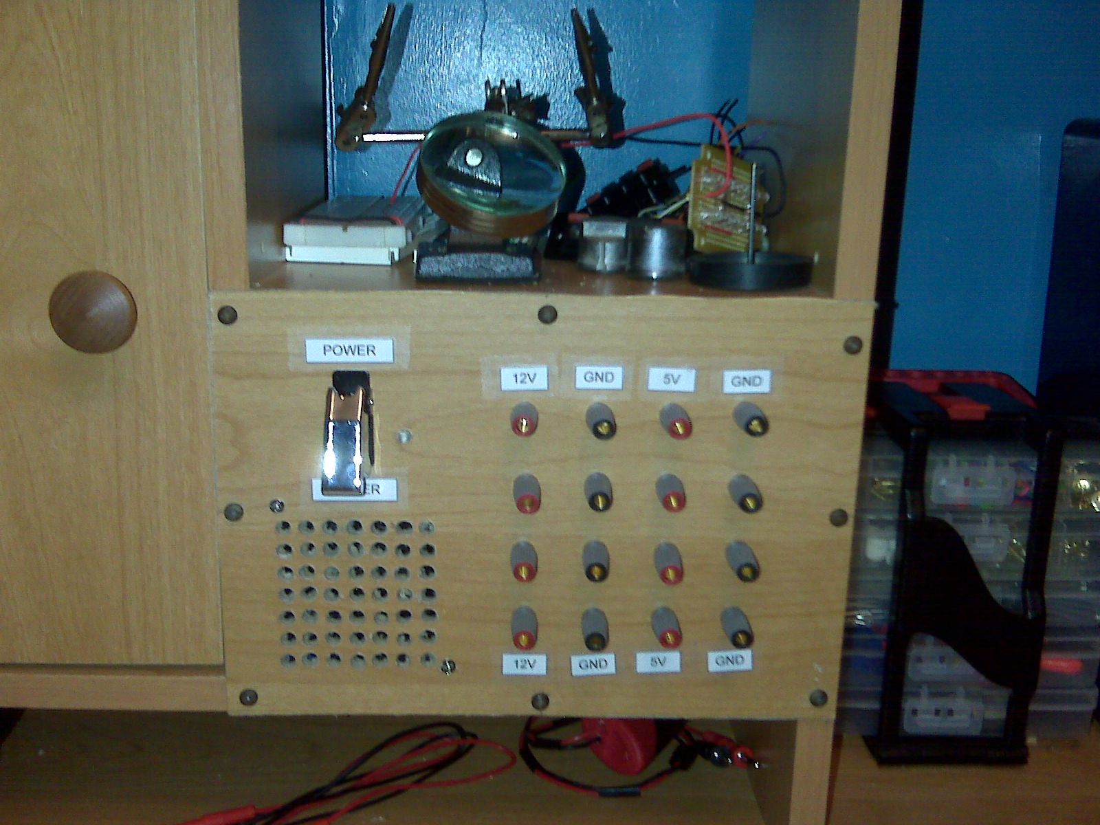

This connector works great with my Shelf Panel Power Supply or any other Banana Jack Compatible Power Supply and work well with most Digital Multi-Meters to test circuits directly on the breadboard.
