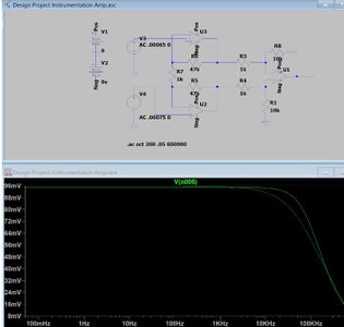

Step 2: Simulating Your INA Amplifier
Again, simulating the circuit components is a very important part, because once you know that they're built right virtually you can just connect components in real life! The first component that we made was an instrumentational amplifier. This component takes the signal sent from your heart and amplifies it to an amplitude big enough to be visualized on an oscilloscope or computer. The INA that we used has a gain of x1000, so the amplitude of a signal input into it will be muiltiplied by a thousand, up to a maximum and minimum value determined by the V+ and V- voltages input into the op-amp.

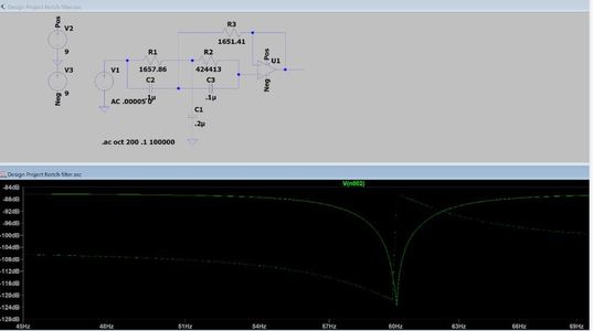

Step 3: Create Your Notch Filter Simulation
The next step is to create a simulation for your Notch filter. This Notch filter filters out signals at a frequency of 60 Hz, while letting other frequencies pass. This is important because 60 Hz frequencies are a common source of interference, as a 60 Hz frequency comes from your power lines. You don't want any interference due to power sources messing with your final results!

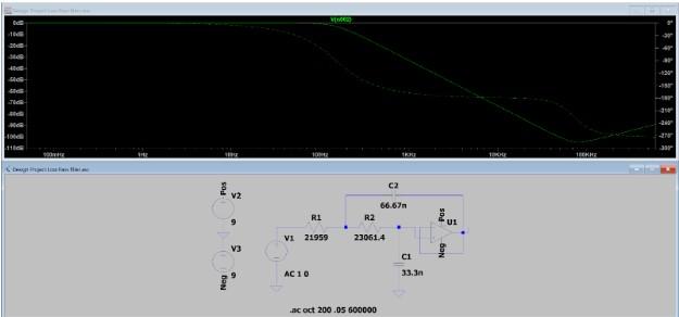

Step 4: Create Your Low-Pass Filter Simulation
Finally, a low pass filter is needed to only let smaller frequencies through. This is because the frequency coming from your heart is low - if your heart beats at 60 beats per minute, that's one beat per second, or 1 Hz! The low pass filter gets rid of any high frequencies so that only the lower ones that are relevant are displayed. Our low pass filter shown above has a cutoff frequency of 150 Hz.

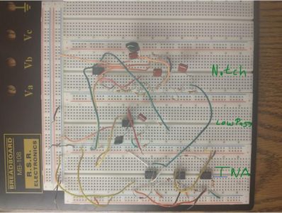

Step 5: Make Your Circuit Components!
Now that you're (finally) done simultating your circuit components, you can start building your ECG! Follow your circuit diagram and build each component separately on your breadboard. Once you've done this we suggest testing each component of your circuit to make sure that it does what you expect it to.
For the low pass filter:
Try a few lower frequencies and a few higher frequencies, and a lot of frequencies around your cutoff frequency (150 Hz). To make sure that it's working you can graph the output voltage divided by the input voltage against the frequency in excel. The graph should look similar to the one output in LTSpice!
For the instrumentational amplifier:
Be sure to connect 9 V batteries to the V+ and V- terminals to create the amplification effect! Then you can input a sine wave to the INA from a function generator and check to make sure that the amplitude of the sine wave is increasing by a factor of around a thousand (up to 9 Volts)
For the notch filter:
Test your notch filter at different frequencies to make sure that it only gets rid of the 60 Hz frequency and lets the others pass. We suggest testing a few low and high frequencies, and a lot around 60 Hz. You can graph the output voltage divided by the input voltage against the frequency in excel to visually check that it's working correctly.
Step 6: Put It All Together
This step's the really easy part! After you're done with the individual testing and know that each component of your circuit works, take the output from your INA and set it as the input to your Notch filter. Once you've done that take the output from your Notch filter and set it as the input to your Low pass filter. The output from your Low pass filter will be the final output that you can visualize either with an oscilloscope or through an arduino (using an arduino is really tricky though and we do not recommend it).

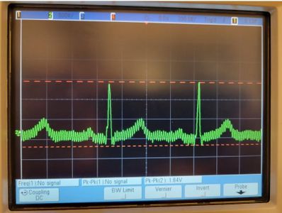

Step 7: See Your ECG!
Last step! (Unless you want to use the Arduino, but still, exciting)
Take three patches and stick them to both of your ankles and your right arm. Then take an lead wire and connect it to your right ankle. Use an alligator clip and connect the other end of the lead wire to the ground on your circuit. This will let your reference point be the voltage from your right ankle. Next, take a lead wire and connect it to your left ankle. This will be your positive electrode, and can be input to one of your input op-amps on your INA filter. Your final lead wire connects to your right wrist, which is your negative electrode. You then connect the lead wire to your other input op-amp on the INA filter.
If you forget which of the two input op-amps the positive and negative lead wires go to you can either try to figure it out from your circuit diagram or just guess. If you guess wrong the waves on the ECG will be upside down - just switch which op-amp you send each input to and it'll be fixed!
Shown above is my ECG, ran through our circuit!
Step 8: Full Set Up
Here's a short video showing our set up! Because I moved my phone to record the video I wasn't staying still, so the ECG readout isn't perfect. A better example of our final ECG readout is the picture shown in the previous step, which is from the same set up but taken by my lab partner while I was holding still :)

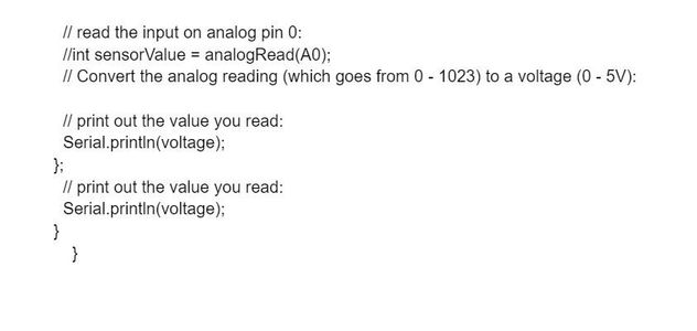

Step 9: Optional Step: Visualize on an Arduino
This is an optional step because, full disclosure, we didn't get the Arduinos to work with our ECG signal. They work in theory.....yeah. To test whether or not your Arduino is working, hook it up to a function generator and run a simulated ECG signal through it. The input to your Arduino should go to pin A0 and make sure to ground it using the ground pin. Use a frequency of 1.2 Hz, which corresponds to a heartbeat of 72 beats per minute. Set the voltage amplitude to be around 1 Volt - although the amplitude from a real heartbeat is a lot smaller, remember that you're just testing using the function generator and so not amplifying your signal with the INA. Finally, plug your Arduino into your computer.
Using the code above, you should be able to see an ECG and a BPM readout! If you want, you can try to hook it up to yourself and visualize your ECG on the comforts of your own computer.
Also, here's the code if you want to look at it not in picture form:
int UpperThreshold = 50; //Thresholding of where to read "beats" based on your signal input
int LowerThreshold = 90; int reading = 0; int BPM = 0; bool IgnoreReading = false; bool FirstPulseDetected = false; unsigned long FirstPulseTime = 0; unsigned long SecondPulseTime = 0; unsigned long PulseInterval = 0;
void setup(){ Serial.begin(9600); }
void loop(){ reading = analogRead(A0); // Heart beat leading edge detected. if(reading > UpperThreshold && IgnoreReading == false){ if(FirstPulseDetected == false){ FirstPulseTime = millis(); FirstPulseDetected = true; } else{ SecondPulseTime = millis(); PulseInterval = SecondPulseTime - FirstPulseTime; FirstPulseTime = SecondPulseTime; } IgnoreReading = true; } // Heart beat trailing edge detected. if(reading < LowerThreshold && reading > 2){ IgnoreReading = false; }
BPM = (1.0/PulseInterval) * 60.0 * 1000; //Serial.println(A0); Serial.print("BPM = "); Serial.println(BPM); delayMicroseconds(3900); { // read the input on analog pin 0: int sensorValue = analogRead(A0); // Convert the analog reading (which goes from 0 - 1023) to a voltage (0 - 5V): float voltage = sensorValue;{ // read the input on analog pin 0: //int sensorValue = analogRead(A0); // Convert the analog reading (which goes from 0 - 1023) to a voltage (0 - 5V): // print out the value you read: Serial.println(voltage); }; // print out the value you read: Serial.println(voltage); } }
