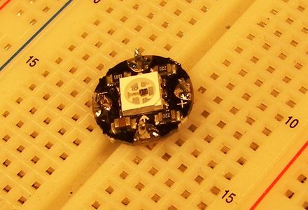

As I do more electronics, I find that some components are harder to use with a breadboard, especially stuff designed for wearables. Soldering pins to the components works but positioning the pins so that they align with the holes on a breadboard can be difficult. This project builds a simple jig that will hold pins in the proper alignment for soldering.

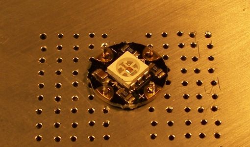

The holes on the right side were drilled using punch marks; the ones on the left were positioned using a digital readout without using a center drill. Notice how the small movements of the drill made these holes come out less evenly spaced. Luckily breadboards can tolerate some misalignment in pins and still work.
I tested the spacing first with a row of header pins to see if they would go into the jig easily.

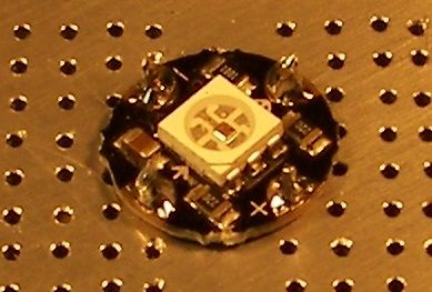

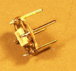

Step 4: First Project With the Jig
My first project with it was a Neopixel that I want to put pins on so that I could start experimenting with it. Here it is with the four pins inserted across the gap. A little solder on each pad. Keep in mind that the aluminum will absorb some of the heat from soldering iron so you will need to use higher temperature to get the solder to flow. Ready to start experimenting.
