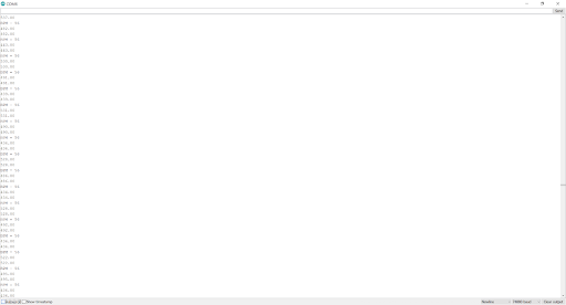

Step 6: Display on Arduino
The display on the oscilloscope can easily be replicated on a computer through the use of an Arduino. To accomplish this, first copy the code shown below into Arduino. Next, connect the output of the ECG to pin A0 on the Arduino and make a ground connection. After attaching electrodes using the lead placement described above, the serial plotter tool can be used to display the ECG signal in real time.

Step 7: Finding Heart Rate
The display shown above from the serial plotter tool has clear peaks from a QRS complex. This can be used as an indicator for a single heart beat. The QRS complex should consistently cross a threshold that no other part of the wave crosses. To calculate the heart rate, assign an upper and lower threshold in the code. When the serial monitor tool is used, the Arduino can calculate how many times the QRS complex occurs within a minute, which is equivalent to the heart rate.
