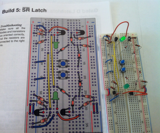

To power the LED, you need to select an LED from 220 Ohms to 10,000 Ohms. The lower the resistance the brighter the LED will be.
Step 6: LED Circuit
The long wire lead of the LED is the red lead in the picture above, and the short wire lead is the blue lead in the picture above. It will not light up if it is oriented incorrectly.
Step 7: LED ON
If everything is hooked up right and the power is on then the LED should light up. If you would like to learn more visit RealCircuits.com.
