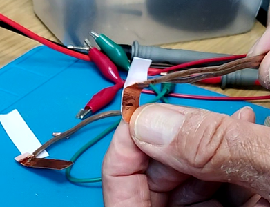

To meaure battery current you have to break the circuit and insert an ammeter. This is fiddly as you have to ensure the meter probes contact the cells without them springing out.
Here is an easy low cost way to solve that problem.
Two core wire, small piece of plastic, small piece of self-adhesive copper tape.
Step 1: Watch the 2 Minute Video
Watch the video, and read below for EXTRA TIPS how to make a VERY thin flexible blade, or a very STRONG but thicker blade (these tips are not in the video, they only in this Instructable).

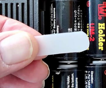

Step 2: Cut the Plastic Insulating Blade
Cut a small bit of thin plastic to this shape - I used plastic from an old milk carton.

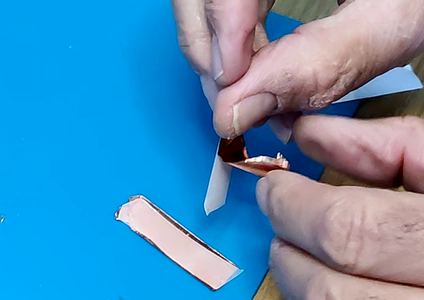

Step 3: Stick the Copper to the Plastic Blade
Stick the copper tape to both sides the plastic blade. It doesn't matter if it overlaps.

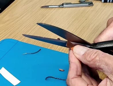

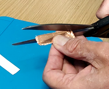

Step 4: Trim the Blade to Shape
Cut the balde to shape and trim the corners so that it will fit in the battery holder.

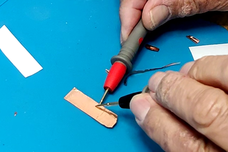

Step 5: Test to Avoid Short Circuits
Do a final resistance check to ensure the sides are not shorting together.

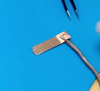

Step 6: Solder Wires to Each Side of the Blade
Strip the wire ends and solder to the blade. Check to ensure there is not a short circuit of the wires.
Step 7: Making a Thinner Blade for Coin Cells, or a Tough Blade for Demanding Jobs
If you want a really thin blade, you can omit the (milk carton) plastic and simply stick the tape back-to-back, but only remove the backing paper from one strip. The backing from the other strip will insulate the two sides. The blade is not as strong, but very thin and flexible. To prevent the wires pulling the sides apart you should use thin flexible wires.
If you need a rugged blade and have the space, you can use a small piece of double-side printed circuit board (PCB).
