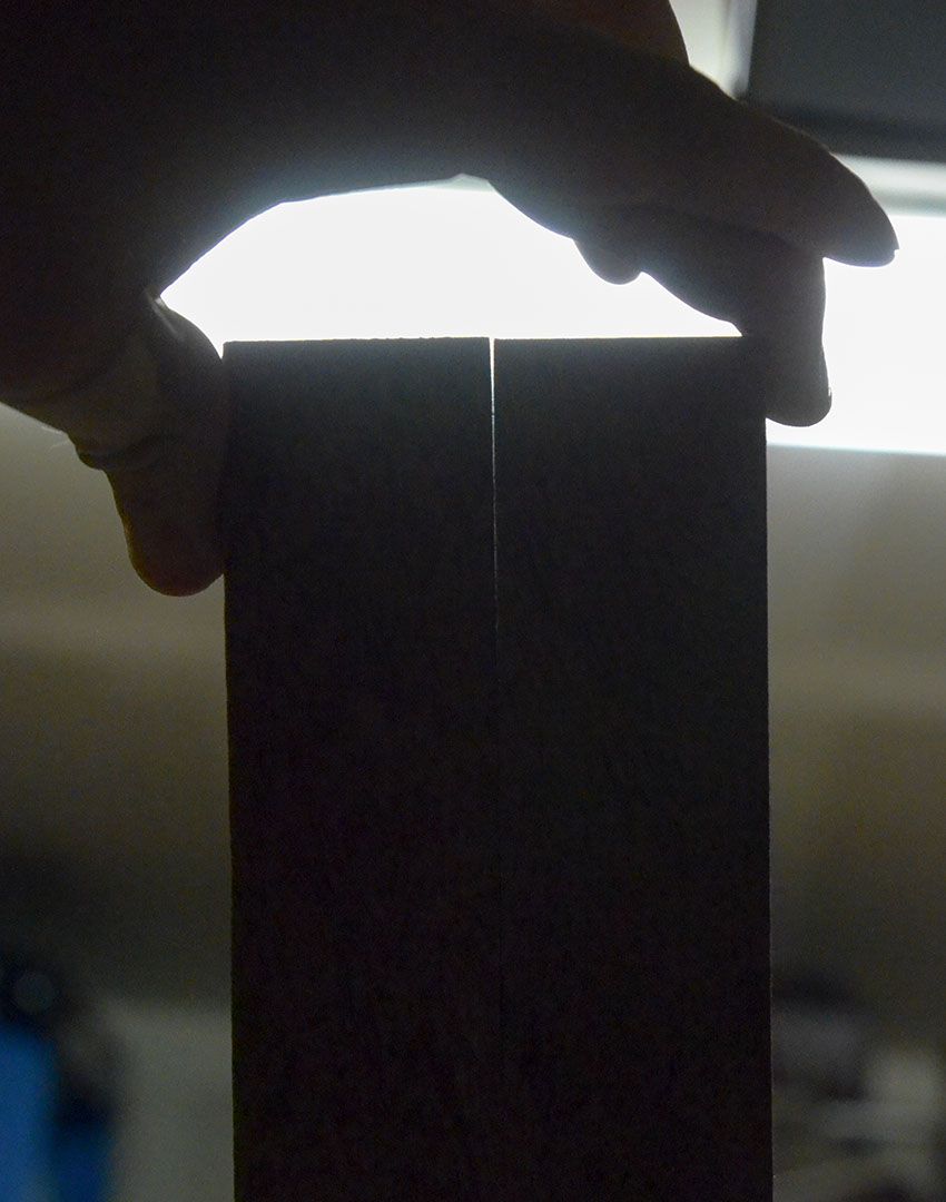

There is a lot of lore out there on how to make perfect glue-ups. Basically, it boils down to getting good clean surfaces, smearing them with wood glue, and clamping them well. There are special tools for getting more surface area, special ways of lining up the wood grain, etc., but two good clean square joints are the simplest and arguably the best way to go.
Tips:
Try not to glue more than 3 boards (two glue-joints) at a time.
- Hold the boards together and check for gaps. If you can see light between them, try to sand or plane the boards until you can't.
