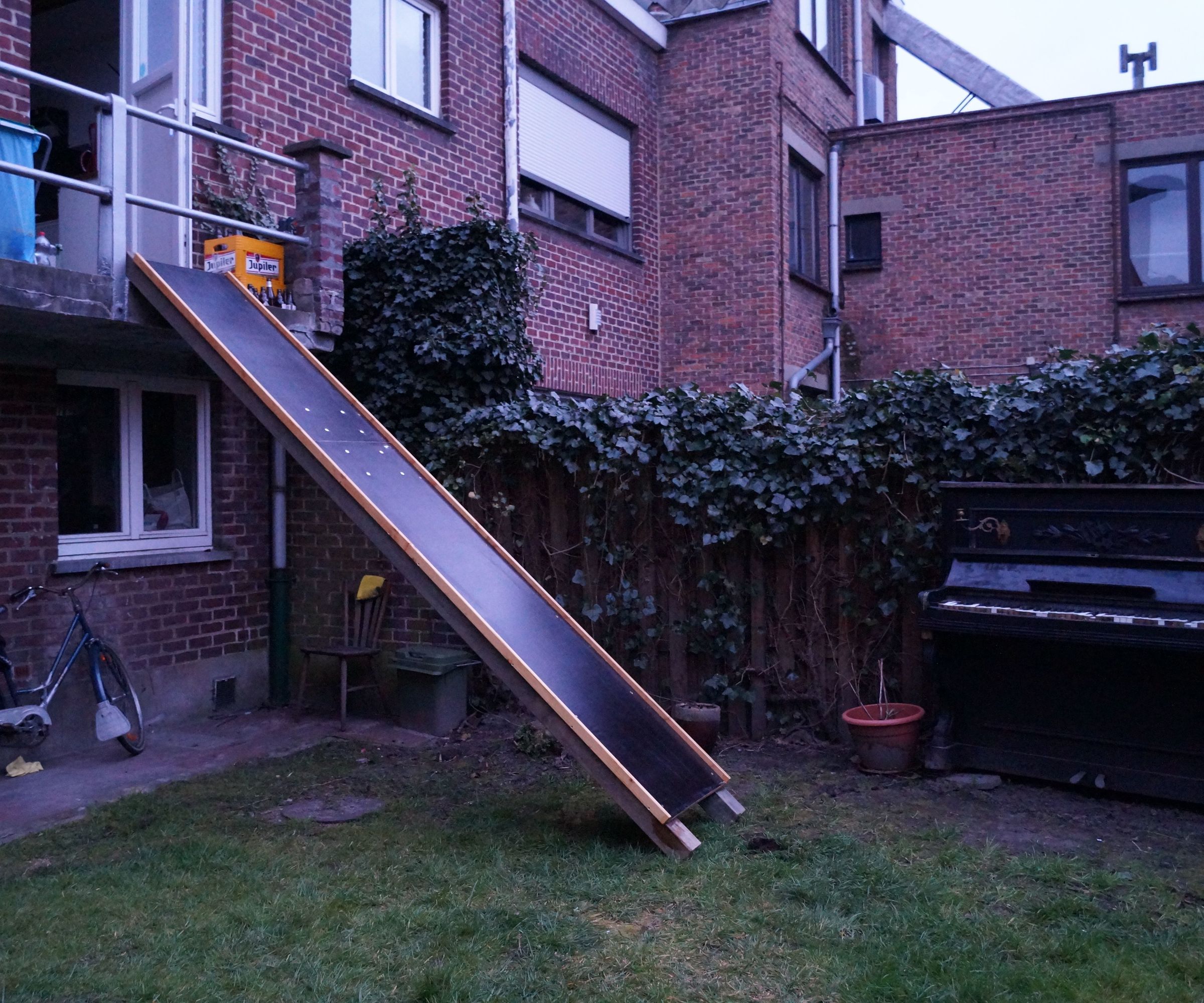

Step 4: Make the Upper Bench
MATERIALS: Wood (I used sandwich material from a door)
TOOLS: Saw (I did it with a handsaw and lat, a table saw is easier)
For the upper bench, I used an old door, that was just the right length to fit over my bed. The sandwich material is also lightweighted, what makes it easier to replace the bench.
It's also possible to make the bench with the planks from long palets close to each other, or with another non-bending wooden plank. If it's for a one-person bed, you can even make this from normal palets.
The measurement are 200x30x3 cm. Because the door is a little bigger, I have a lot of tolerance, but that's not necessarily needed.
I didn't cover the sandwich materials on the sides yet. Somebody who has tips to do it easily: shoot! :)
