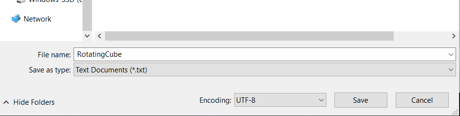

The first thing you need to do is open your text editor. For this project I'm just going to be using Notepad. Before we start writing the code, we need to save the document, save it as an .html file. I called mine Breakout.html but you can call it whatever you like. Also make sure that the file is encoded in UTF-8.

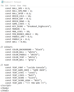

Step 3: Game Paremeters
After writing our basic html layout we can start writing the game parameters. These are the constants that we can change any time we want. Here is a list of constants that you can change:
BALL_SPD is the balls starting speed which is (BALL_SPD/1) x height of the screen per second
BALL_SPD_MAX is the max speed the ball which is itself times BALL_SPD
BRICK_COLS is the number of brick columns
BRICK_GAP is the gap between each brick which is (BRICK_GAP/1) x width of the wall (all of the bricks)
BRICK_ROWS is the starting number of brick rows
GAME_LIVES is the starting number of game lives
MAX_LEVEL is the amount of levels in the game with each level having +2 rows of brick
PADDLE_SPD is the speed of the paddle which is (PADDLE_SPD/1) x width of the screen per second
PADDLE_W is the width of the paddle which is (PADDLE_W/1) x width of the screen
Step 4: Colors
Once we finish writing the game parameters, we can write the colors. Sadly we can't really change the color of the bricks. Here is the list of constants you can change:
COLOR_BACKGROUND is the color of the background
COLOR_BALL is the color of the ball
COLOR_PADDLE is the color of the paddle
COLOR_TEXT is the color of the text
COLOR_WALL is the color of the margin
Step 5: Text
Now we can write the text. This is essentially the font of the text, all the words, the win text and the lose text. Here is a list of things you can change:
TEXT_FONT is the font of the text
TEXT_GAME_OVER is the text said when you lose
TEXT_LEVEL is the text next to the level you're at
TEXT_LIVES is the text next to your lives
TEXT_SCORE is the text next to the score
TEXT_SCORE_HIGH is the text next to your high score
TEXT_WIN is the text said when you win

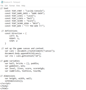

Step 6: Definitions
This is just a tiny section that defines our movement with numbers 0, 1 and 2. In this case, left is defined as 0, right is defined as 1, and stop is defined as 2. Stop is just what we use to define the up key on your keyboard.
Step 7: Canvas and Context
After writing the Definitions, we will set up the canvas and context. This will be used to create the graphics of our game.
Step 8: Game Variables
Now we need to write the game variables. Our variables are going to be ball, bricks = [], paddle,gameOver, win, level, lives, score, scoreHigh, numBricks, textSize and touchX.

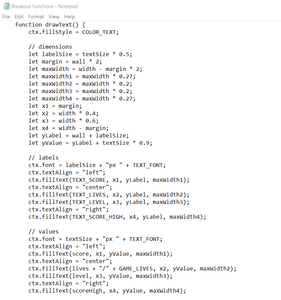

Step 19: Function DrawText
This functions creates and colors the text with the color we chose at the start. This function then places each piece of text that we chose into its assigned area.

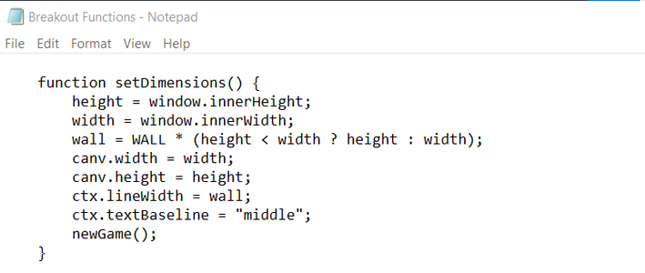

Step 29: Function SetDimensions
This function sets the walls that the ball bounces off of.

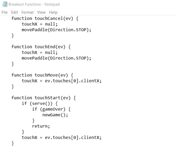

Step 31: Function TouchCancel, TouchEnd, TouchMove, and TouchStart
The touchCancel, touchEnd, touchMove, and touchStart functions are all for if your using a device that is touchscreen. If your computer is touchscreen, try it out with the end result.

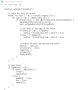

Step 33: Function UpdateBricks(Delta)
This function allows each brick to detect ball collisions, bounce the ball off itself, and destroy itself if the ball hits it. It also updates the amount of brick once there is a new level.
