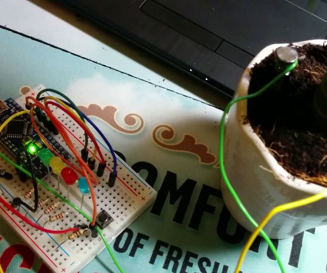

I’ve added some LEDs just to indicate what’s going on. The green LED is to show that the device is on and OK. The red LED shows that the switch is on and, thus, the heat mat is on and heating up the fermenting vessel. Finally, the blue LED shows that the switch, and heat mat, are off and that the vessel is cooling down to room temperature.
The best way, I found, to test the whole device is to have the DHT22 under the lamp as when the lamp comes on the heat from the bulb will bring the temperature up and the whole system goes into an on/off cycle. The lamp heating the DHT, the lamp goes off, the DHT cools down, threshold is reached and the lamp comes back on again. And so on.
