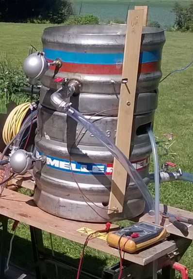

Step 3: Hardware
1) : The bom
First of all, before to start to build your brewery, you need some components. So this is the list of all what you need to start your own brewery at home. This list is only about the installation.
  • 2 empty barrels
  • 2 heating resistances
  • 1 fermentation barrel + 1 bubbler
  • 1 filter
  • 1 cooling cool
  • 1 DC motor
  • 1 mixer
  • 2 taps
  • 2 PT100 sensors

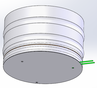

2) : Few cutting to do in both barrels.
We need to cut the top of the upper barrel. This will allow us to place the filter inside this one.
[Picture 1]
For the filter, we advised you to use a perforated stainless steel sheet. In this one, we have to make a circular cutting. The diameter of this one depend of the inside diameter of your barrel.
[Picture 2]

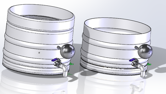

4) Adding of the taps and the Pt100 sensors
In this step, we will drill 2 holes in each barrel. One for the tap, the other for the Pt100 sensor. The first hole for the tap has to be lower enough to only lets flow the liquid below the filter. For the second hole, you should be thinking that the Pt100 sensor has to be immersed. We advised you to do it half of the barrel's height. Now a picture of these 4 holes done.
[Picture 10]
These 4 holes done, we have to attach the taps and the Pt100 sensors. The taps are welded to the barrels. For the Pt100 sensors we use a bolt and nut system to do it.
[Picture 11]
