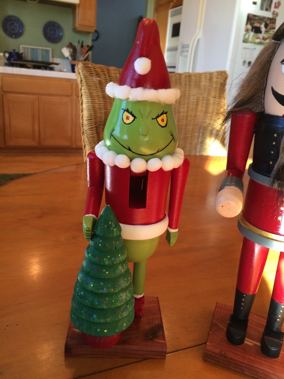

I started making Nut Crackers a few years ago when I could not find a Grinch Nut Cracker for sell. I created 4 in 2014, and in 2015 created Wizard of Oz Nut Crackers... This year was special as my oldest son was getting married on 1/7/17 so I thought I would create Bride and Groom Nut Crackers.

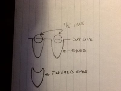

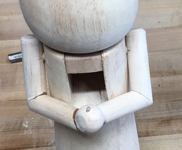

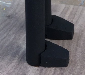

For the Groom I need to add legs, so I mark 2 - 1/2" holes on the bottom of the body and drill these on a drill press. While I have the 1/2" drill in the chuck I will drill 2 holes in 1/2" thick wood that will be used for shoes, see sketch and photo. Next I mark the bodies 1/2" down from the top, where you just cut the slot, and drill 1/4" hole on 2 sides of the body. I mark the arms 1/2" down as well and drill 1/4" holes in each arm 1/4" deep. You can now cut the arms to give them bends or leave them straight. If you cut the arm at a 45 degree angle and rotate the bottom half you get arm bent 90 degrees at the elbow.
I also drill the pin hole to hold the lever arm to the body. This is the hole just back of the arm hole. I drill this with the lever arm in place as a match drill. I use a 3/16" stainless Steel metal pin 1 3/4" in length.
