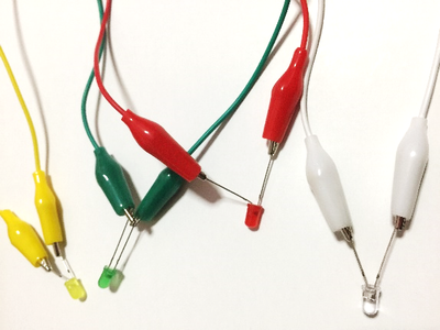

Step 4: Connect LED Lights to Breadboard and Arduino Mega
Hardware Components Required
1. Breadboard
2. Arduino Mega
3. 4x Resistors (220 Ohm)
4. 4x LED (Red, Yellow, Green, Multi-RGB)
5. 8x Double-end Lead Alligator Clip Wires
6. Female-to-female Jumper Wires
Steps to Connect LED Lights to Breadboard and Arduino Mega
1. Establish a common ground by connecting the negative rate from breadboard to GND pin of Arduino.
2. Insert the resistors by connecting one leg to the negative rate.
3. Before connecting the LEDs to the breadboard and Arduino, you need to be aware of the LED pins. The short pin is negative lead and the long pin is positive lead.
4. Connect the jumper wires to each end of the resistors, parallel to one another.
5. Connect the other end of jumper wires with alligator clip wires.
6. Connect the other end of alligator clip wires to the shorter leads of LEDs.
7. Use a new alligator clip wires to connect the longer leads of LEDs with female-to-female jumper wires.
8. Connect the other end of female-to-female jumper wires to the Arduino.
⮎ For example:
o Red LED to pin 16 of Arduino
o Yellow LED to pin 14 of Arduino
o Green LED to pin 15 of Arduino
o Multi-RGB LED to pin 17 of Arduino

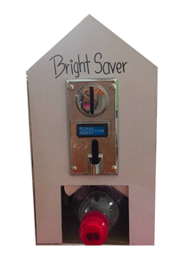

Step 7: Assemble the Bright Saver’s House
Tools Required
1. Cardboards
2. Hot Glue Gun
3. Screws
4. Evian Mineral Water Bottle, 750ml
5. Permanent Markers
6. Penknife
Steps to Construct the House
1. Firstly, I measured the coin acceptor’s interior in order to attach it to the front of the house and attached it with screws. Also, I have cut the bottom of the house to insert my coin bank.
2. Do remember to build an exterior with strong support inside of the house to make sure that the house is able to carry weight by preparing cardboards to act as a support for the coin acceptor and coin bank.
3. Insert your Arduino and Breadboard inside the house.
4. Place the LCD and buttons by cutting holes at the side of the house. Do take note that the LCD is still attached to the Breadboard.
And.... tada!!! Introducing.. Bright Saver!
