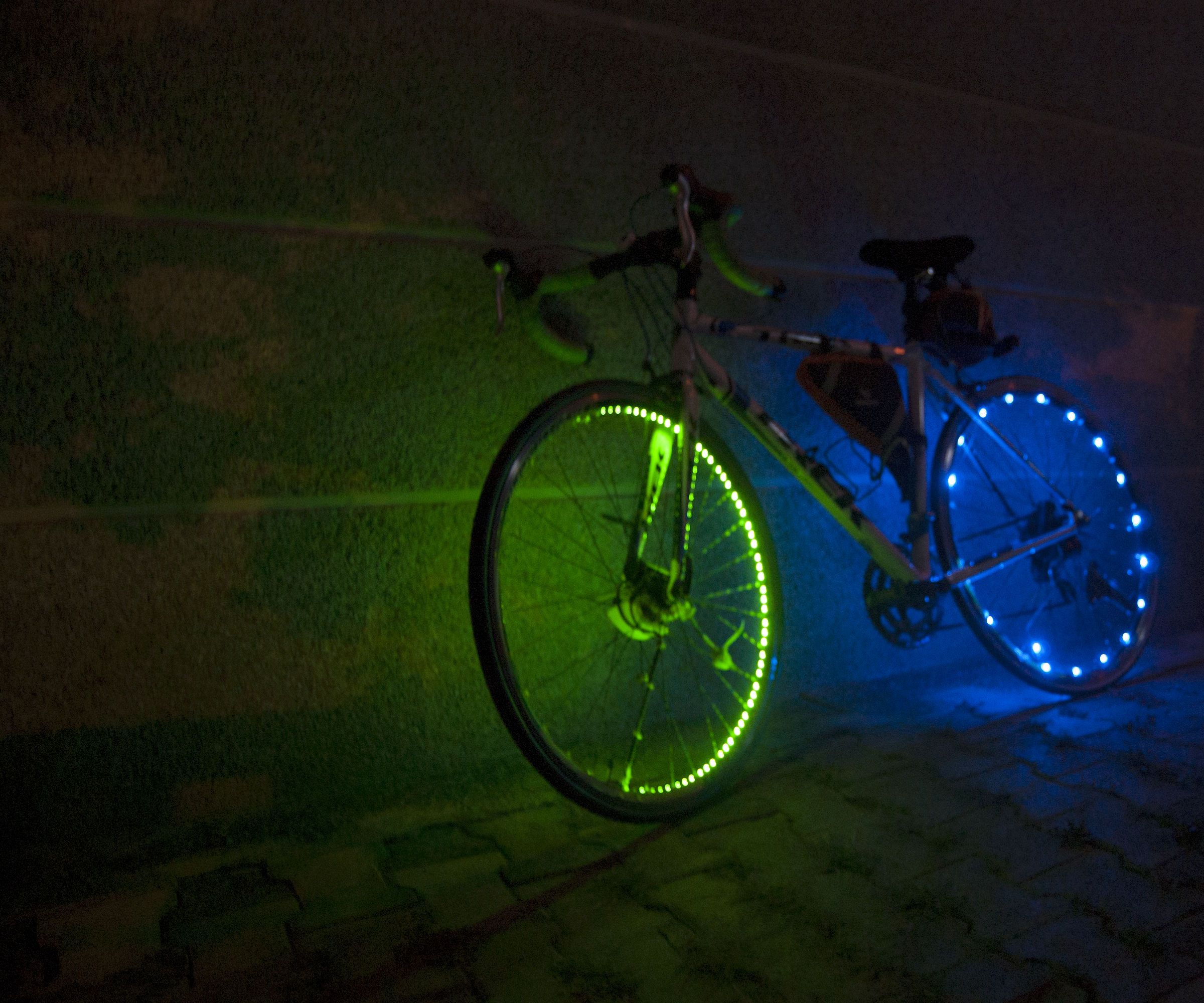

One can not always allow the latest technology and innovative products either on a whim or security, but as Einstein said "In moments of crisis only
imagination is more important than knowledge."
! So all those who dream of colored lights on the wheels as I! and now can not afford them, here is a solution .....
The model in the picture is one that incorporate green blue, and white LEDs, to simplify the model will be composed of blue LEDs only.

Step 5: Overview of Assembled
The steps in more detail are the following:
- Peel all necessary cables.
- Cut the cork portion is separate and the longitudinal axis parallel to the surface where they are LEDs, to form a loop inside the holder.
- Check that all LEDs work.
- Insert the LEDs on the top of the cork holder.
- Solder the LEDs in parallel.
- Add the resistance to the positive leg of the first LED to regulate the proper intensity of the LEDs.
- Solder the potentiometer to the circuit this is the element that provide the possibility to adjust the brightness of the LEDs, the middle leg above resistance welded to the
LED, and the two remaining legs one at positive and one at negative switch switch.
- The switch that will connect with the battery support for this we will have to leave about 7 or 8 inches of wire from the switch out of the bracket.
- Once placed all electronic components add silicone top bracket where components are assembled to make them waterproof and protect them from the elements.
-Add the bottom of sosporte and paste everything with silicone.
- Take the outgoing cables of the switch and add the JST THE female connector, add silicone to the holes and a cable where competitive termoretactil welds.
- Insert the male connector JST THE battery cables, check that follow the same cruiterio of signs that the other connector, square circle positive or negative and positive
or negative, the preference you want, add silicone to the holes and a cable termoretactil where competitive welds.

Step 6: Cheking
Once assembled and connected to the battery intensity lights may be low, medium or high
