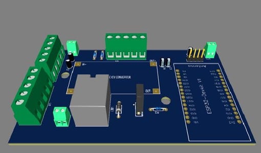

I designed the circuit, fabricated the PCB, and created a 3D-printed casing for the PCB to make it compact and durable. It takes about 4-6 hours to assemble if you have basic soldering and 3D printing skills.
This system is "brine solution automation" because it's tailored for handling saline (brine) liquids, but it can be adapted for other fluids. Safety note: Ensure all components are rated for your liquid's corrosiveness—brine can be harsh on metals.

Step 2: Circuit Design and Wiring
Pins Configuration:
Relay ---- D13
Button ---- D19
SDA ---- D21 (Display)
SCL ----- D22 (Display)
Sensors
D34, D35, D32, D33, D27

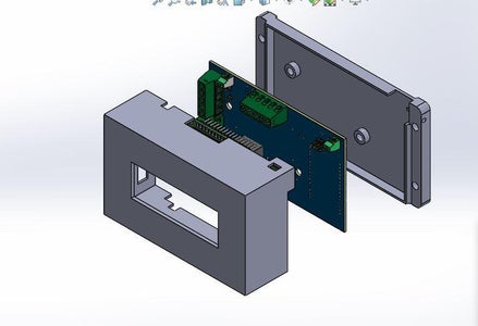

Step 3: 3D Modeling the PCB Casing
I designed the casing in SolidWorks. The model is a box enclosure with:
  1. Cutouts for LCD screen, button, and sensor wires.
  2. Mounting points for the PCB (standoffs).
  3. Lid with screws for easy access.
Print with PLA+ filament.
