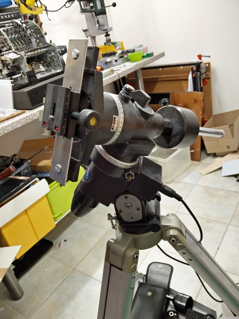

I bought this mount a long time ago and it rested years in the basement. I thought about to use it (again) to make astrophotography.
This led to some steps I had to do:
- I had clean the whole mount and remove the old, chewy grease out of all bearings. I followed the instructions on Optimierung Vixen SP to accomplish this.
- Second: build a new tracking device, as driver-IC in the old one were blowed ;-) and nowhere available anymore.

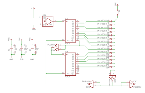

Howto get 9.62Hz?
This was some kind of an educational challenge, because I didn't needed it in the end.
I had a 7.3728 MHz Crystaloszillator. If you divide it by 765901, you get 9,62Hz.
To divide it I used two CD4040 (see image).
This circuit would be sufficient, if you only want to drive the right ascension axis using some stepper driver, but I wanted more.
Howto get 9.62Hz and more?
As I had to implement three independent running timers (2 stepper and the longtime timer), I decided to feed an arduino hardware interrupt with 10kHz and use counters to trigger actions every X calls of the interrupt. I.E. if I call the interrupt 10000 times, one second has passed.
For the 10kHz I used an 1MHz Crystaloszillator an divided it by 100 using two 7490 (See final step).

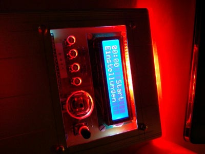

Step 2: Longtime Timer
This one made things complicated because a user interface had to be implemented.
The first try was to use the Adafruit RGB LCD Shield, but this was in conflict with my hardware interrupt because of the i2c bus (very strange effects). So I had to switch to a native 16*2 LCD display and 4 switches. These 4 switches had to be sufficient to build a UI because now all IO PINs of my arduino were used.
The timer itself used the same technique, the stepper use. But with a constant threshold for the interrupt.
The user can set the timer by modifying each digit of a MM:SS display, can start the timer and i able to change some settings. To know, which function is requested, when a button is pressed, a byte value is used to store the blinking cursors' position. This way, it is clearly identifiable, what the user sees when he presses a button and it can be checked using a simple switch command. (See Sourcecode)

Where is the error?
At first I wanted to check, if the stepper runs to fast or to slow. So I took photos every 1 minute and on the photos, there was a tree and bright Jupiter. Both went in the same direction, so my stepper is to fast. Using a frequency meter, we found out, that the interrupt was called with 12.5kHz, not 10kHz.
It turned out that, the 2nd 7490 failed, it did divided the 100kHz in by 8 not 10. After replacing this IC, a quick test - before the clouds hid the stars - was successful :-D
