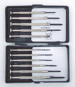

- A precision screwdriver set (Laptops have various sizes of screws inside them)

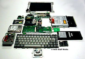

2. Carefully take apart your laptop. You can normally find a guide on how to take apart your specific model by searching on Google. Normally if you were taking apart a laptop you would need to remember where each screw and component go, but not this time.
Set all important parts to the side as they become available.
These include, but are not limited to:
- Motherboard (Make sure to set aside the screws and posts that hold it in place)
- Hard drive
- Keyboard (I recommend a USB keyboard though, as the laptop keyboard will be quite awkward to use)
- CD/DVD drive
- Any other important parts (Card readers, internet cards, speakers, etc.)
I would get a USB mouse instead of the touch pad too. If it's not usable, that doesn't help you much.
3. After you have it taken apart, put the important parts on a piece of cardboard or some other non-static surface. Put it together and power it on to make sure you kept all needed parts. If it does not turn on, you probably left something out. Take everything apart and try again. Maybe it is just a loose cable or something.
