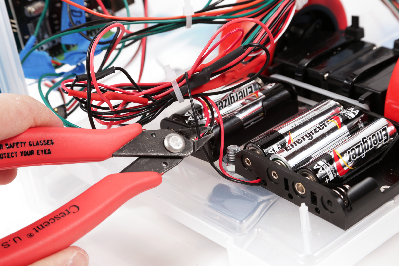

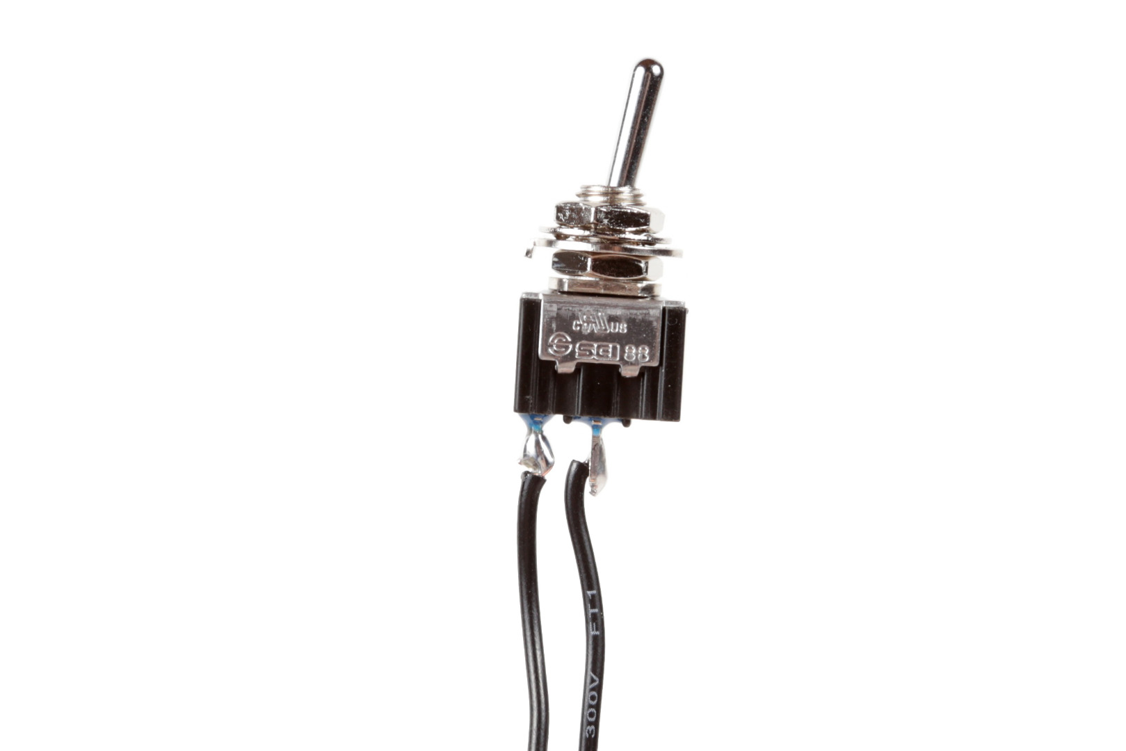

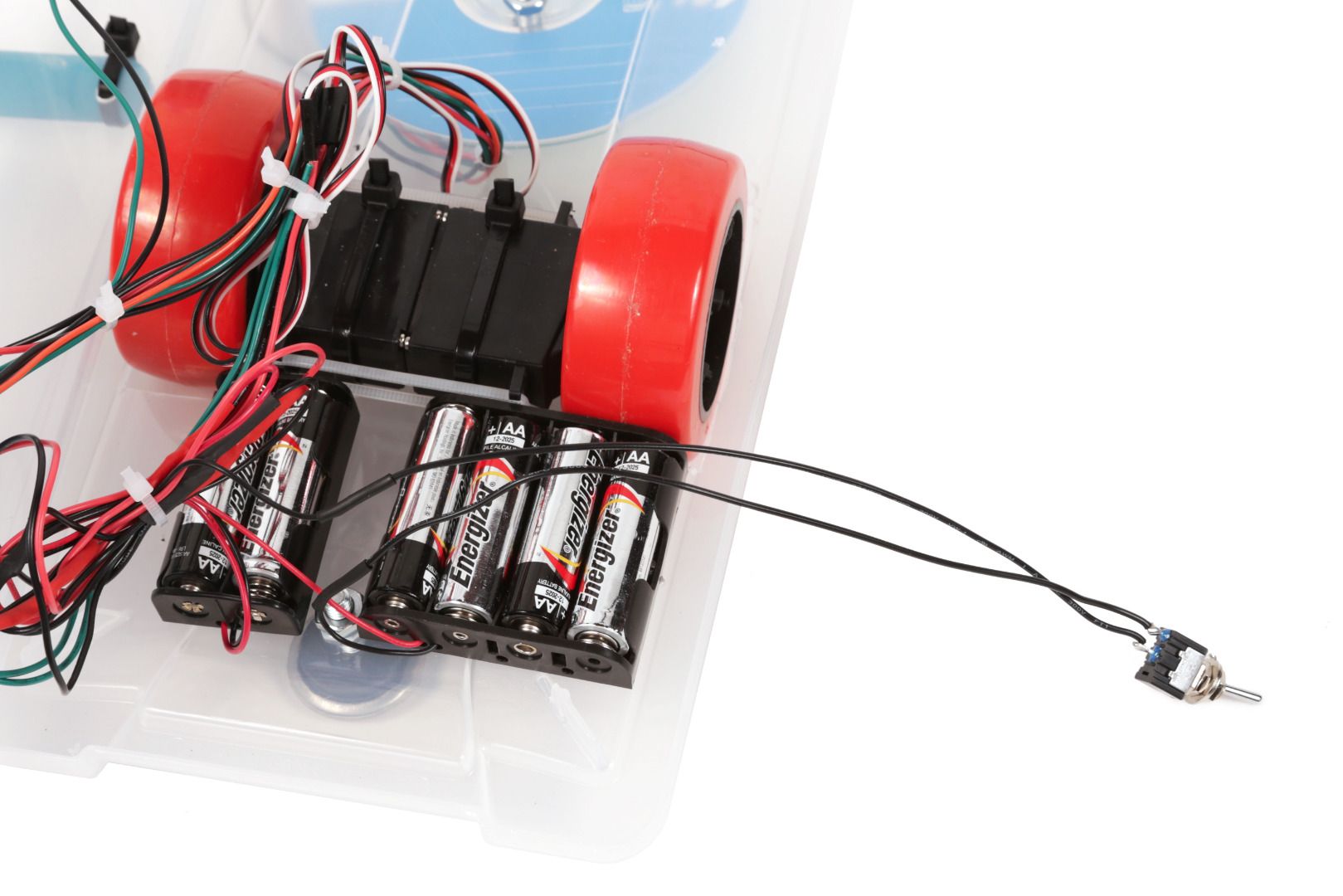

Find the black wire coming off of the 4 X AA battery holder and cut it in half.

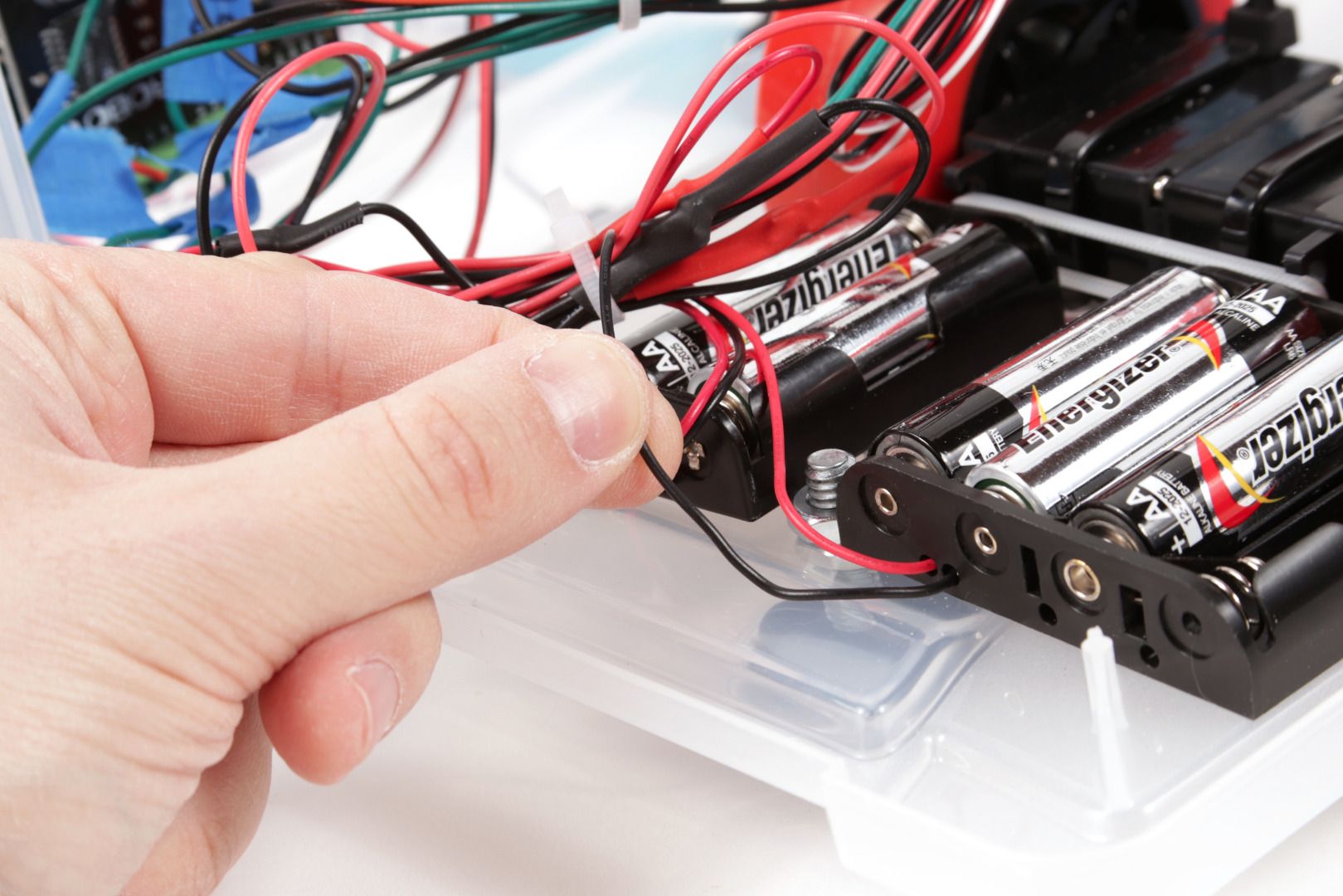

Get an SPST toggle switch and attach two 8" black wires to it.
Solder one of these wires to one of the halves of the black battery holder wire and insulate it with shrink tube. Solder the other black wire to the other half, and insulate it as well.

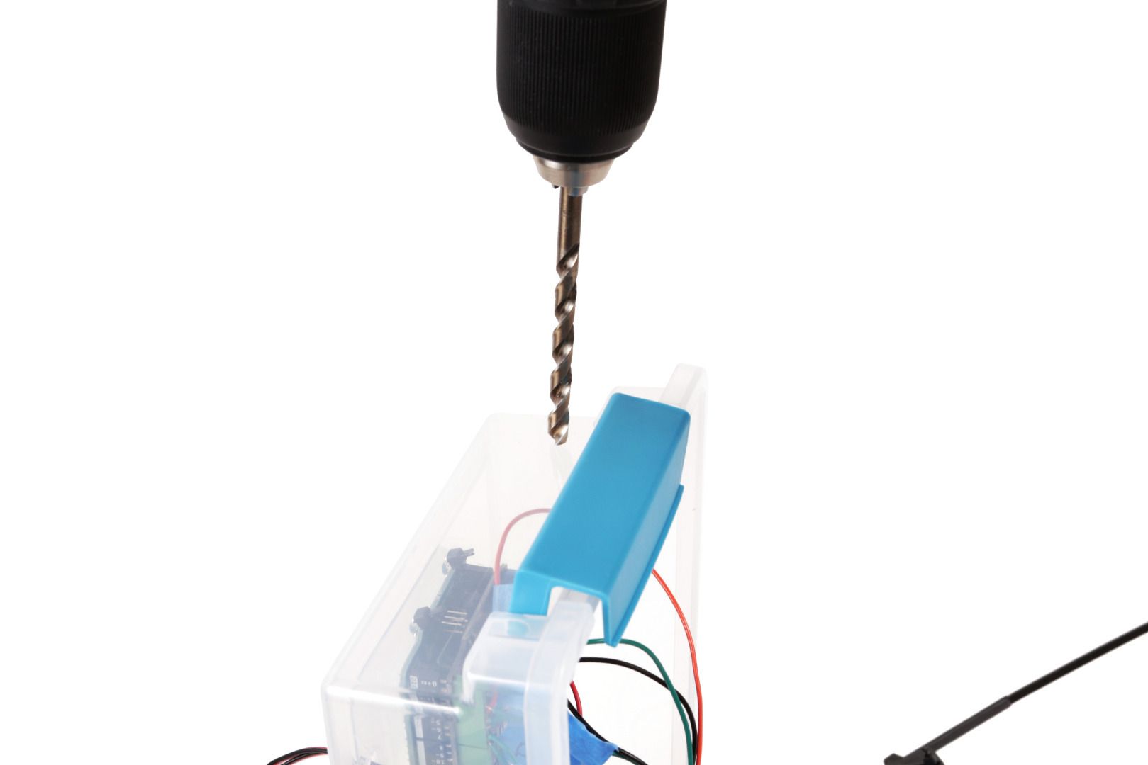

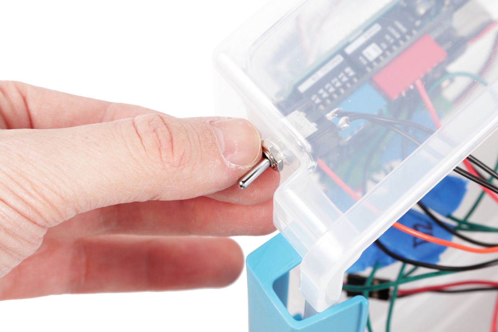

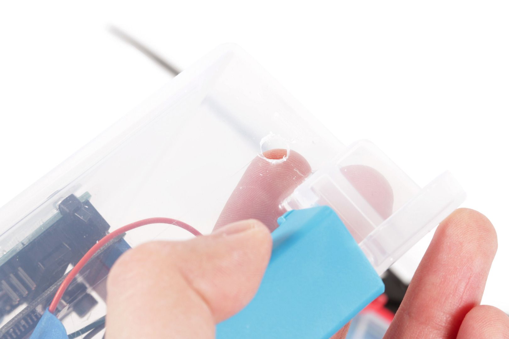

Drill a 1/4" hole (or whatever size is appropriate to mount your switch) in the plastic box.

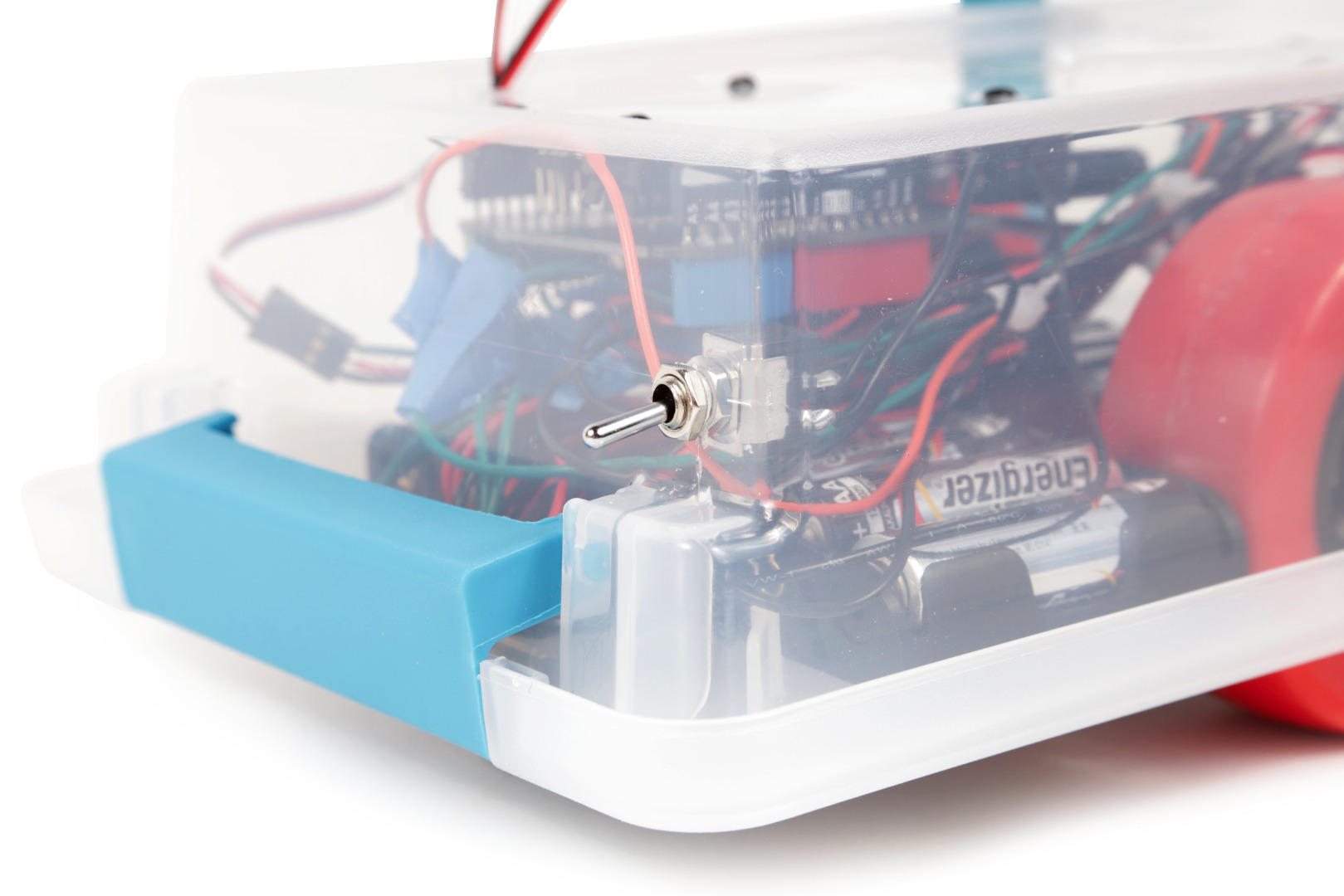

Mount the switch in the hole that you just drilled.
Congratulations, you now have a power switch.

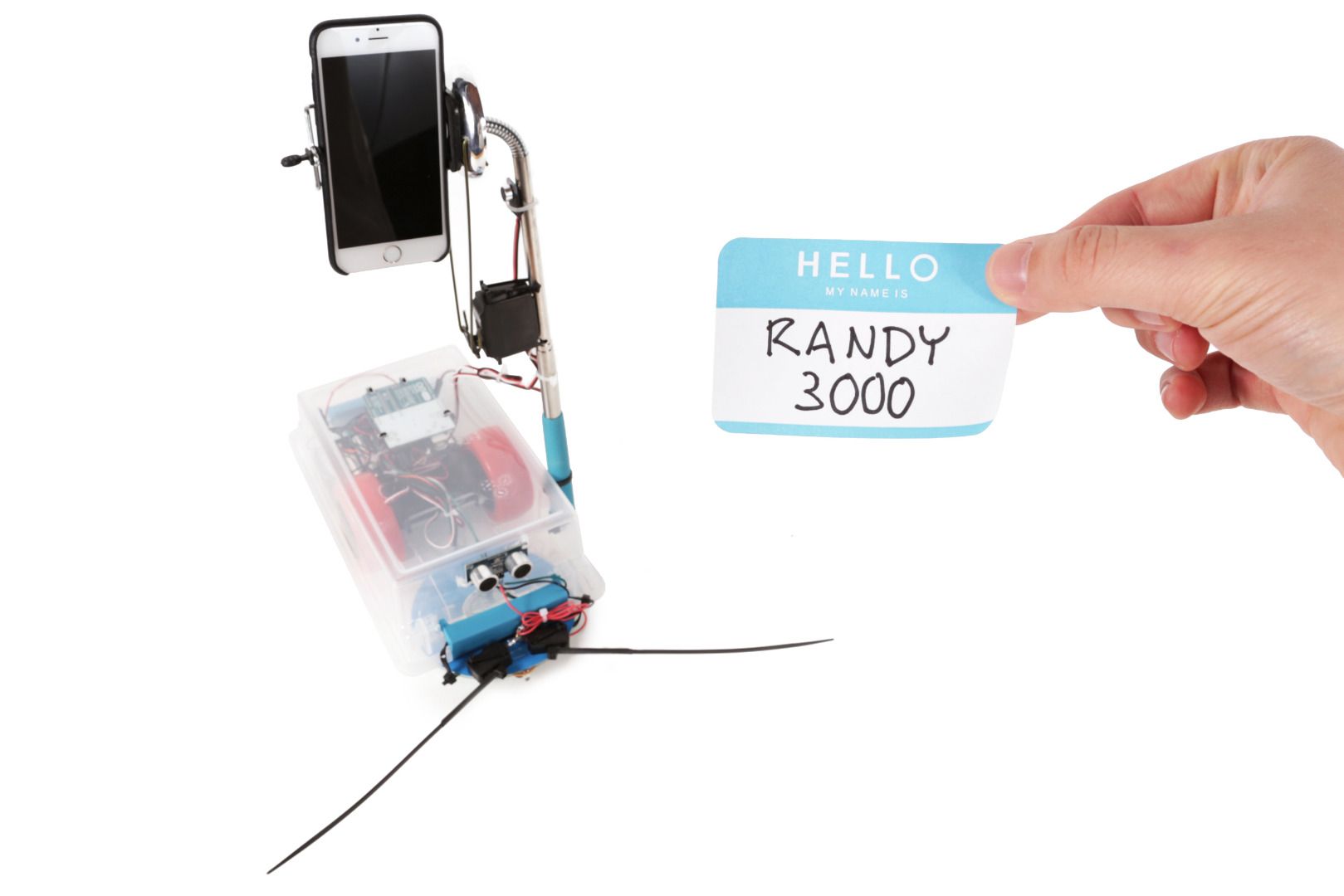

Lastly, you can give your robot a name.
I named mine Randy 3000, in homage to Andre 3000 of the seminal southern rap group Outkast.
