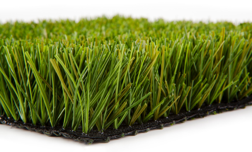

There are many types of Turf/grass on the market. This all depends on your preference if you like long grass wavy that slides in-between your toes or grass that feels like a golf course putting green.

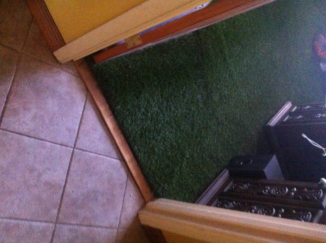

When I started to cut my grass I put each peace in my room as I went. This way I could pick out the next biggest piece I needed to cut.

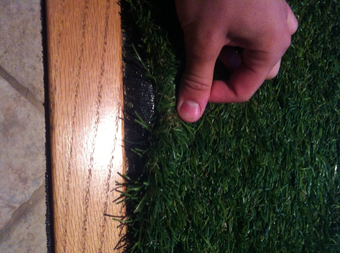

After I had all the grass lined up I needed to secure it. As you can see in the pictures I started with the “Tong” of the grass. The tong is the fabric part of the grass that sticks out along the side. I screwed in into the threshold of the door it was a great fit. Next I used small concrete bolts at all the corners, they where screwed in using an impact gun (sorry I don't have pictures). Finally I realized that the seam in the middle of the floor was coming undone, I cut small slits in the base of the grass and used a zip-tie to join them together.
