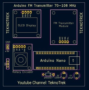

Before starting the project, we designed the circuit schematically. You can see the schematic below:

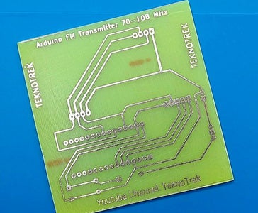

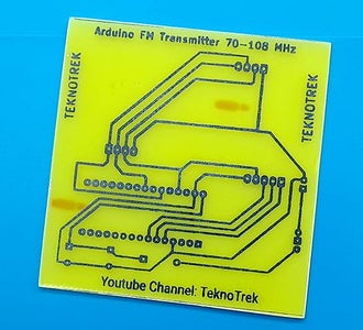

We tested the components on a breadboard according to the schematic and then designed a PCB for soldering.

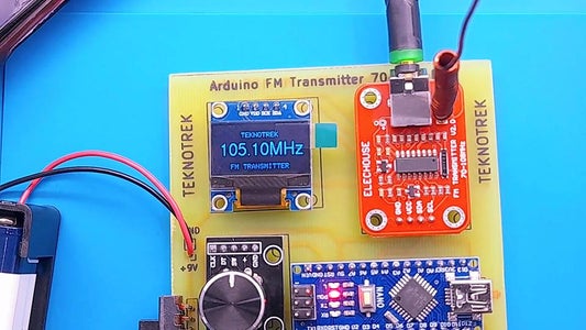

Step 8: Result
The circuit worked successfully, and the FM frequency was displayed on the OLED screen. We were able to adjust the frequency using the rotary encoder.
