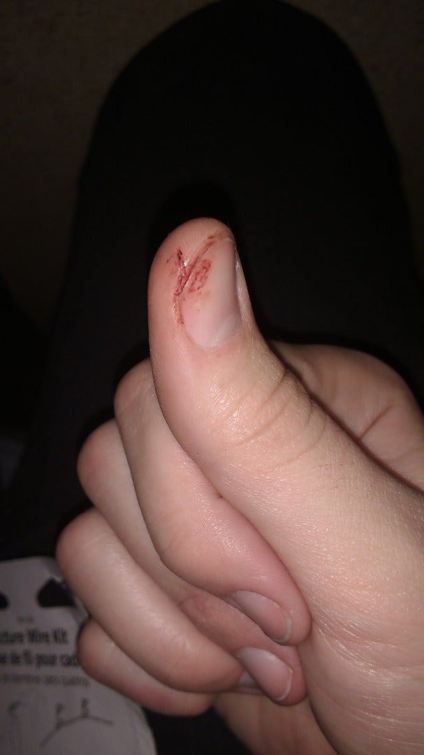

IMPORTANT NOTE: When you break your mirror(s), be SURE to wear protective gloves and eye wear, plus long sleeves, pants, and closed-toed shoes. This may sound like overkill, but believe me it's necessary as the mirror pieces will fly EVERYWHERE! I cut my hand open with my first swing of the hammer from not thinking I needed gloves. It may be a small cut (thankfully), but nonetheless, the mirror showed me it wasn't messing around! So be prepared, and get covered!

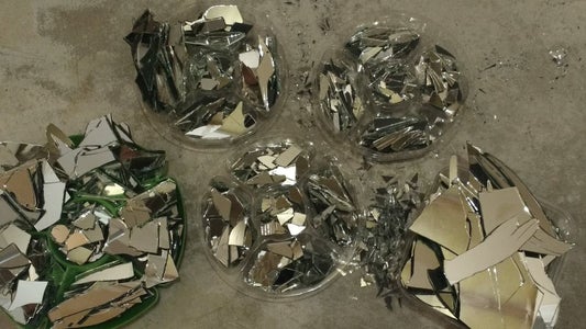

Take your hammer (a regular one, not a sledgehammer, will do), and bust that puppy into pieces! Make sure to leave some pieces larger and some smaller, depending on the type of design you're wanting to achieve.
TIP: For ease of access when planning out your mirror pieces for your art, organize them in different containers by the type of mirror piece it is. For instance, one container will be for long, rectangular pieces. Another might be for short triangles. Just try to put them together in such a way that you can find a "small, medium, large, extra large" piece with ease and in the basic type of shape you're looking for.

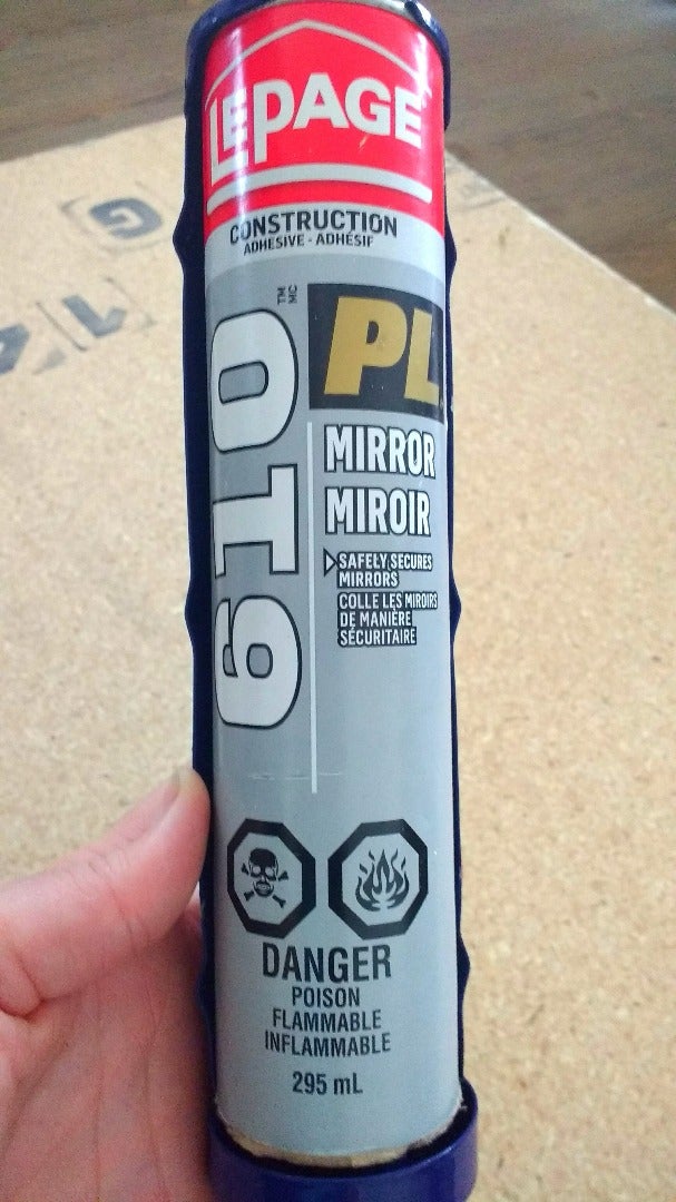

I could've probably asked that same friend for this, but...I am not a mooch...hahaha. So I went to my local Home Depot and got LePage Construction Adhesive 610 Mirror Mastic (aka mirror "glue") and a cheap caulking gun. The guy tried to sell me on some $20 caulking gun...no thank you, sir. My $2.98 caulking gun worked great and is STILL working great, thank you :) Moral of the story: don't get hustled, lol.
Be aware, this stuff will squeeze out of every edge of smaller pieces (it's truly only ideal for larger pieces). But since my art was more detailed, I went for it all-in. After laying my pieces out in the exact designs I wanted, I began the gluing part, keeping a meticulous eye on putting them back just the way I pulled them up. This was actually quite a breeze. A little stinky, but a breeze ;)

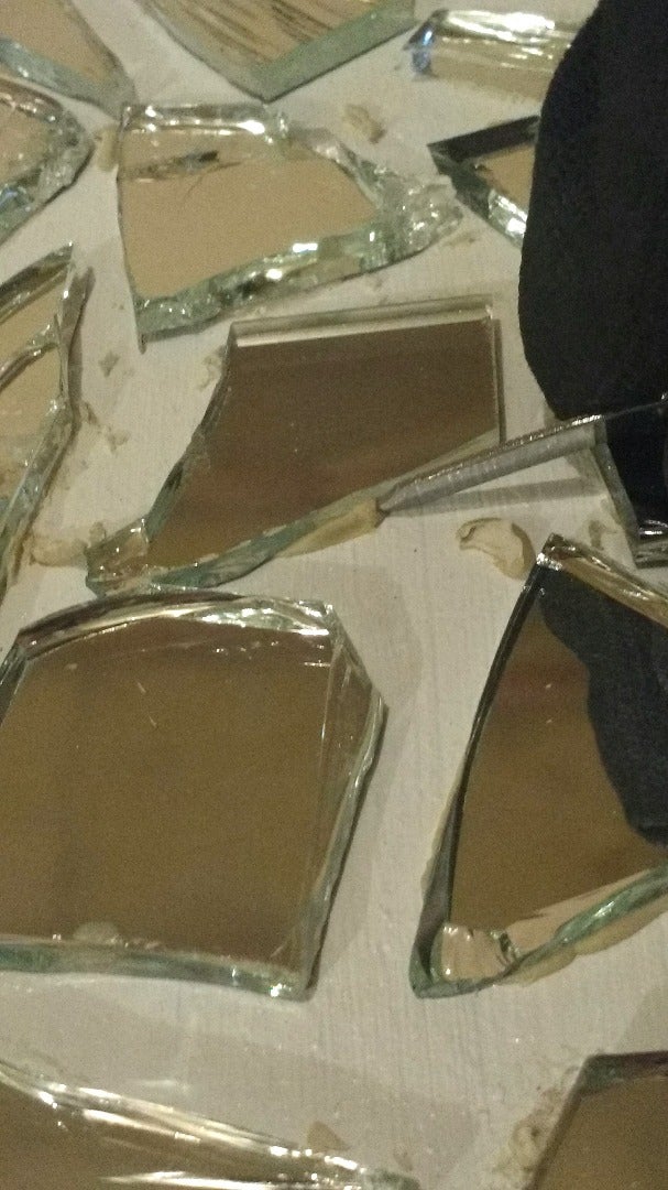

Step 3: Remove Excess Mastic
Ok. So...I originally wrote in this instructable that I removed the excess mirror mastic with the nail file extender from a set of fingernail clippers--which is still accurate--but I originally did it dry. Meaning, I scratched and scraped at it with the pointy metal nail file and it worked (eventually), but not well.
Therefore, here's the new approach I learned that works 100% better: Use heat. If you want to take less time and effort (and not scratch and ding your artwork up as much), use a hairdryer!
1. Turn the hairdryer on High. Allow it to heat up for about 10-30 seconds.
2. Hold the hot hairdryer over a section of mirror pieces that have been secured to the wood backing with mirror mastic. Keep the hairdryer at least a couple inches away from the mirror pieces.
3. As the mastic heats up, it will become pliable (but not runnier like when you first applied it). Then it will scrape up easily with the metal nail file.

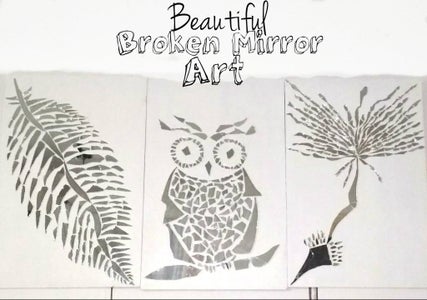

YOU'RE DONE!! Now when everyone walks in and sees your statement masterpieces, they will ask you about them, ooh and ahh over them, and even take pictures of them (yes--this has happened to me...and it's actually quite an honor to be an inspiration to someone!). Let your inner creative cat out, and go make your own masterpiece!
*Next DIY: making a simple large frame for these three pictures to make them stand out against my white wall as "one" big piece! Stay tuned...
