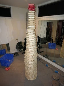

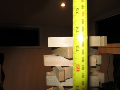

In the end I have over 850 to play with! YES the tower is over 6 feet tall!!!
The only thing more fun than building is busting that sucker down!

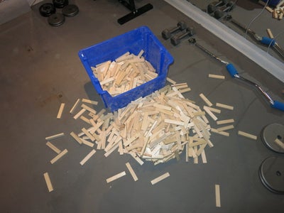

I required 1:3:15 ratio. In SAE inch terms, the planks need to be .25 by .75 by 4.75. I chose to add 1/16 inch to all dimensions in flawed thinking of the next steps.
There is a couple of ways to go about cutting the tiny planks.
The first is to run the 2X4 through the saw all at once. My saw is less than precision so this idea wrecked more than it produced.
Ideally you will be wanting to remove all the factory edges from the poorly cut construction grade material.

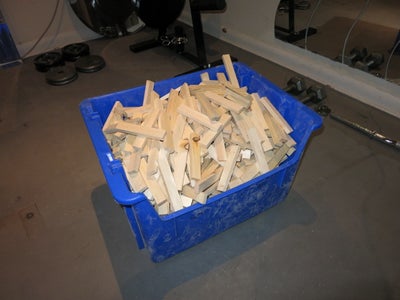

I ended up cutting into 4.8 inch sections for easy processing. This was then cut into 7 usable pieces.
I got 20 sections from each 2X4.
Time to turn the table saw on for a couple of hours.

So initially I planned on sanding each individual piece. Crazy, yes I know but I hate splinters.

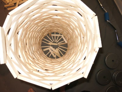

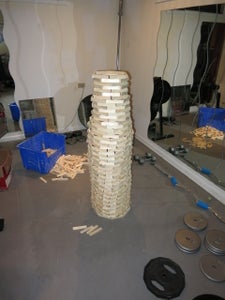

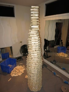

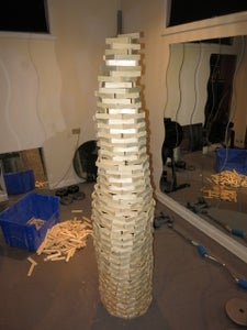

The best way to sort the good from the bad is to actually build something.
I chose to make a tower.
The best advice I can give for this is to not stay on one side. Your tower will lean towards you... move around to prevent this. I did not!!!
The sanding idea died as the build progressed!
I like the tactile feel of the rough wood and it seems to build a stable structure. What??? No one is going to call phrasing here????
After a couple of hundred pieces you will begin to develop a sense for when a piece is not right. Hard to explain but it happens if you let it. By feel you will begin to sort the pieces that are not uniform. toss these to the bin and work with what is right.

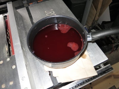

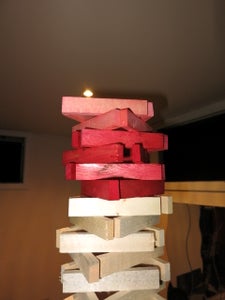

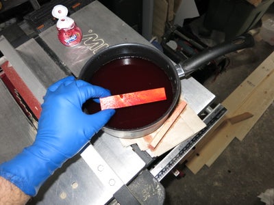

Step 3: Dyeing for Wood

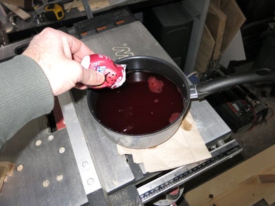

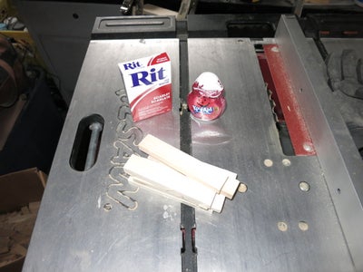

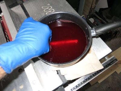

So I thought to make some of these in colour. Years ago Kool Aid was an amazing dye source. Today, 8 stores and no powder. Again Calgary fails!

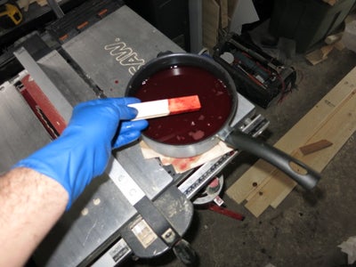

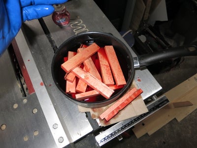

I tried 2 types of dye, Kool Aid cherry liquid and RIT fabric. RIT is the way to go.

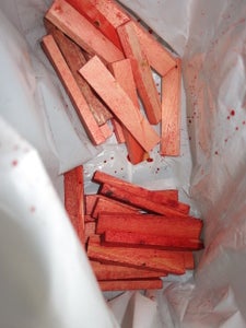

A cold water and a quick dip as all that in needed. Soaking will destroy the precision of your cut pieces.
I processed several samples of each and Kool Aid liquid just plain sucks! But it smells great!

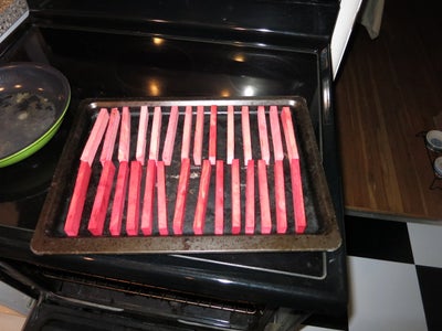

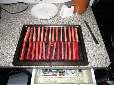

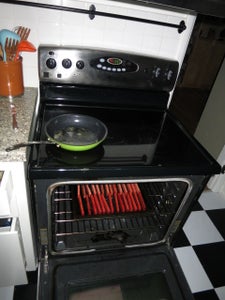

Since kiln dried wood will suck up as much moisture as you give it, you will need to dry any dyed piece.
I recommend an oven at 350 for about 15 mins.

The spoke elements in the second pic are not necessary and they serve no purpose.
