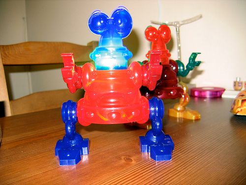

Step 2: Break Open the Bubble Machine
First you'll need to open up the bubble machine. The one I found was easy to open, just four philips head screws.
Once inside, disconnect the battery and motor from the switch and solder wires for both the motor and the battery pack long enough to feed outside of the machine.
Next, use a Dremel tool to make an opening in the plastic to feed the wires out.
If you like colorful bubbles, attach the LED or ThingM BlinkM on the top of the machine.
Finally, I opted to place a mini-breadboard on the back of the bubble machine to collect all the wires. This made it easier to adjust the distance between the controller and the unit.
