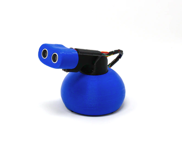

Buddy is a 3D Printed arduino social robot. He interacts with the world by using an ultrasonic sensor to map out his immediate area. When something changes in his environment he reacts. He can be surprised or inquisitive and sometimes a bit aggressive.
Buddy sees the world by updating particular points in a map around him. These points are updated as he moves around and reacts to new things.
If an object is placed in or removed from his vicinity he will react by potentially searching it out or becoming angry. Maybe sometimes sad or disappointed. These reactions are generated in the moment as his world changes. Buddy generates his actions on the fly. Each one is completely original and based on what is happening around him. He never recycles a reaction.=

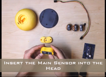

Step 3: Insert the Ultrasonic Sensor Into the Head
Press the ultrasonic sensor firmly into the 3D printed front-facing head piece

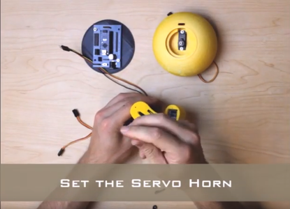

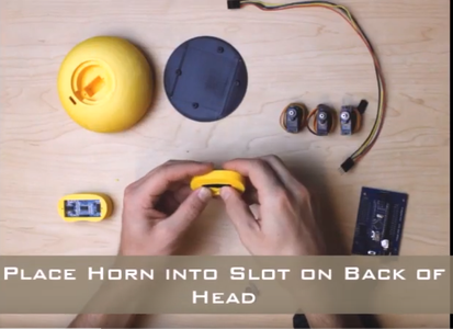

Step 4: Insert Horn Into the Back of Head
Take the back half of the head and set a two-prong Servo Horn into it.

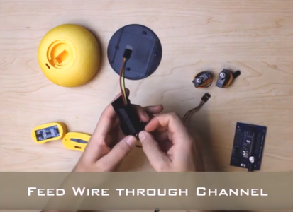

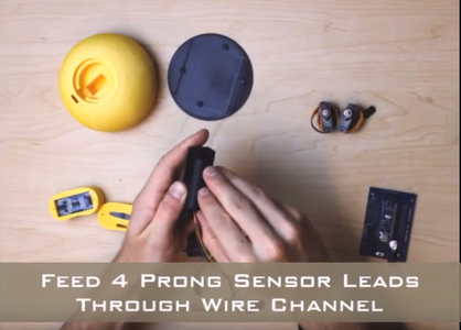

Step 5: Feed Sensor Wire Through Neck
Feed the 4 prong sensor wire through the channel on the neck

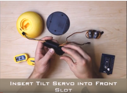

Step 6: Insert Tilt Servo
Insert the Servo into the the neck that tilts the head from side to side

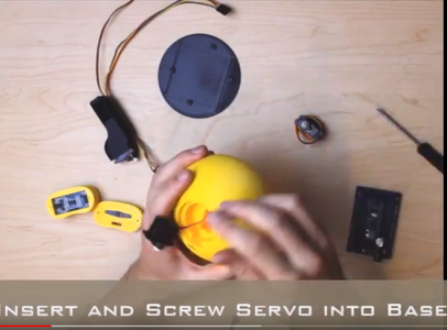

Step 8: Insert Base Servo
Insert and secure with screws a servo into the base .

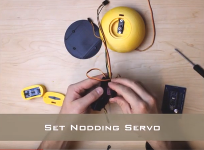

Step 9: Set Nodding Servo
Insert the Nodding servo into the neck. It does not require any screws

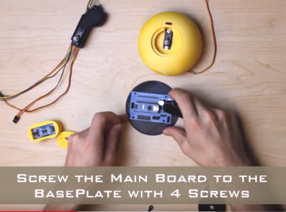

Step 10: Set Mainboard
Use 4 servo mounting screws to set the main arduino board into the base of the robot.

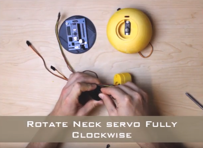

Step 11: Rotate Tilt Servo Fully CW
Use a spare horn and gently, manually rotate the servo fully clock-wise

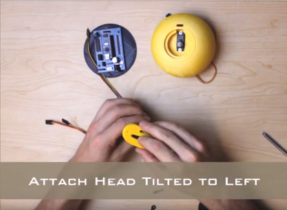

Step 12: Attach Head Base to Servo
  • Mount the base of the head so that is it is tilted to the left a little less than vertically.
  • Secure with a servo horn screw.

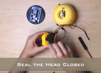

Step 13: Seal the Head Closed
  • Connect the sensor wire to the sensor, noting which color wires go with which pin on the sensor
  • Seal the Head closed with 2 servo mounting screws

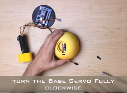

Step 14: Turn the Base Servo CW
Turn the Base Servo Fully Clock-wise. Gently. Use a spare servo horn.

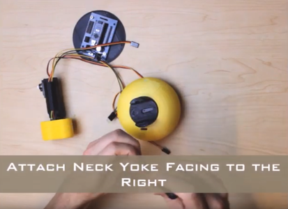

Step 15: Attach Neck Yoke
Attach the Neck yoke piece to the servo so that it is facing 90 decrees to the right.Secure with horn and screw

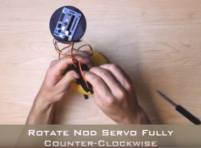

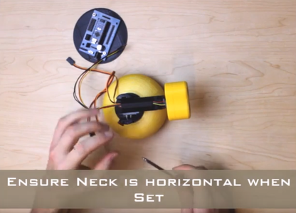

Step 16: Attach the Head and Neck
  • Rotate the Nodding Servo fully CCW
  • Attach the Neck and head to the neck yoke. Insert by tilting the servo armature in and then twisting the neck into place.
  • Secure with a horn and screw. Make sure that the neck is horizontal or slightly below.

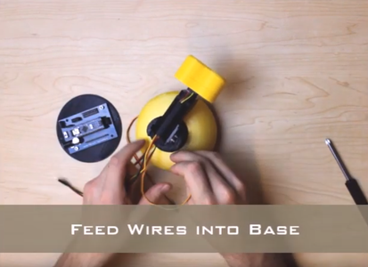

Step 17: Feed All Wires Into Base
Feed all servo and sensor wires into the base.

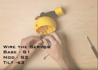

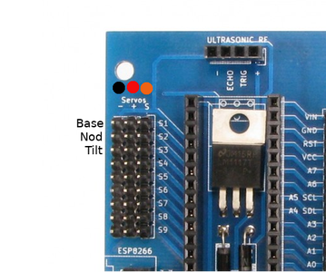

Step 18: Wire Sensor and Servo
  • Wires servos to the main board according to the diagram.
  • Plug in the Sensor Wire to the ultrasonic port. Make sure that the pins are aligned with the pins on the sensor

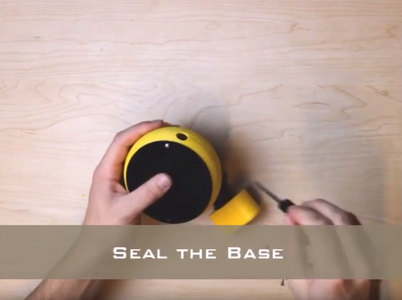

Step 19: Seal the Base
Use 4 servo mounting screws to attach the base plate to the main body
