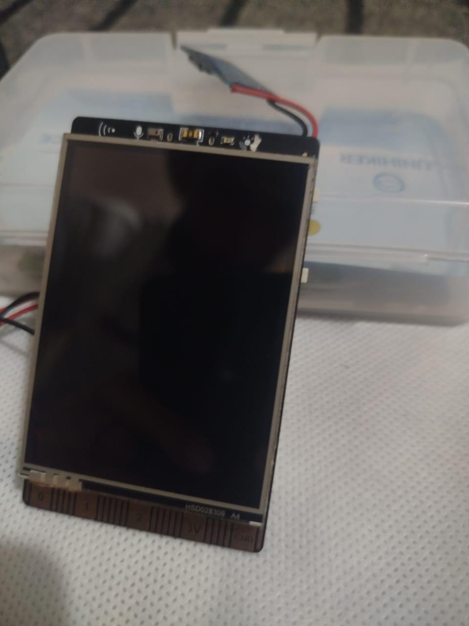

Running on the Unihiker Single Board Computer (SBC) and powered by Python, Buddy combines the open-source software with the portability and power of an Unihiker. Whether you need a calming playlist to help you focus, a reminder to take a break, or just a reliable timer to track your work, Buddy is here to guide you through the day. In this article, I’ll walk you through how this works, how it was developed.

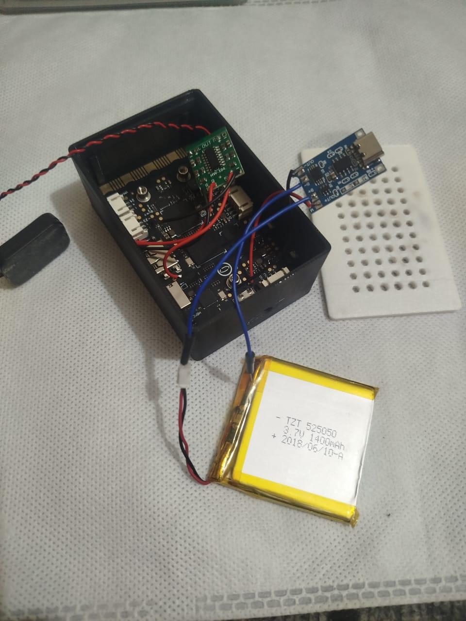

Things You'll be In need of:
  1. Unihiker
  2. PAM8403 Amplifier Board
  3. Tp4056 Module
  4. 3.7v 1400 mAH battery
  5. 3d Printed Enclosure
  6. Laptop with VScode
And you will be in need of Soldering Iron, File or sandpaper and wire stripper.

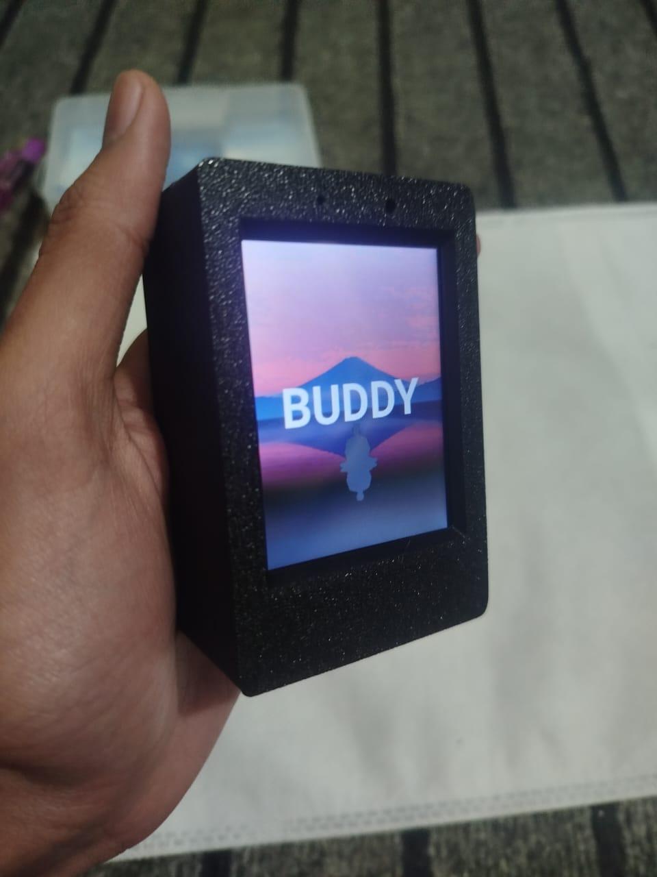

So I have designed this GUI based on three screens.
First is main screen Which displays text Buddy animation in and out.
It has background image from pinterest.

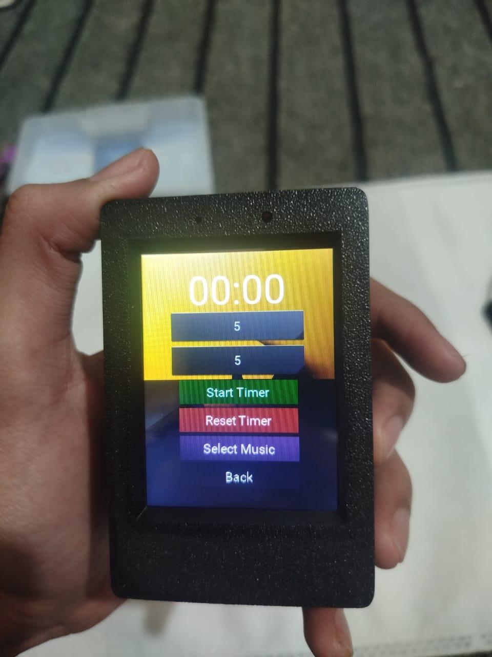

Second screen, this is the main screen. It has the Timer and button to adjust the Time duration, break time, and Music selsction and Start Timer and Reset Timer. And a button to Go back to main screen.

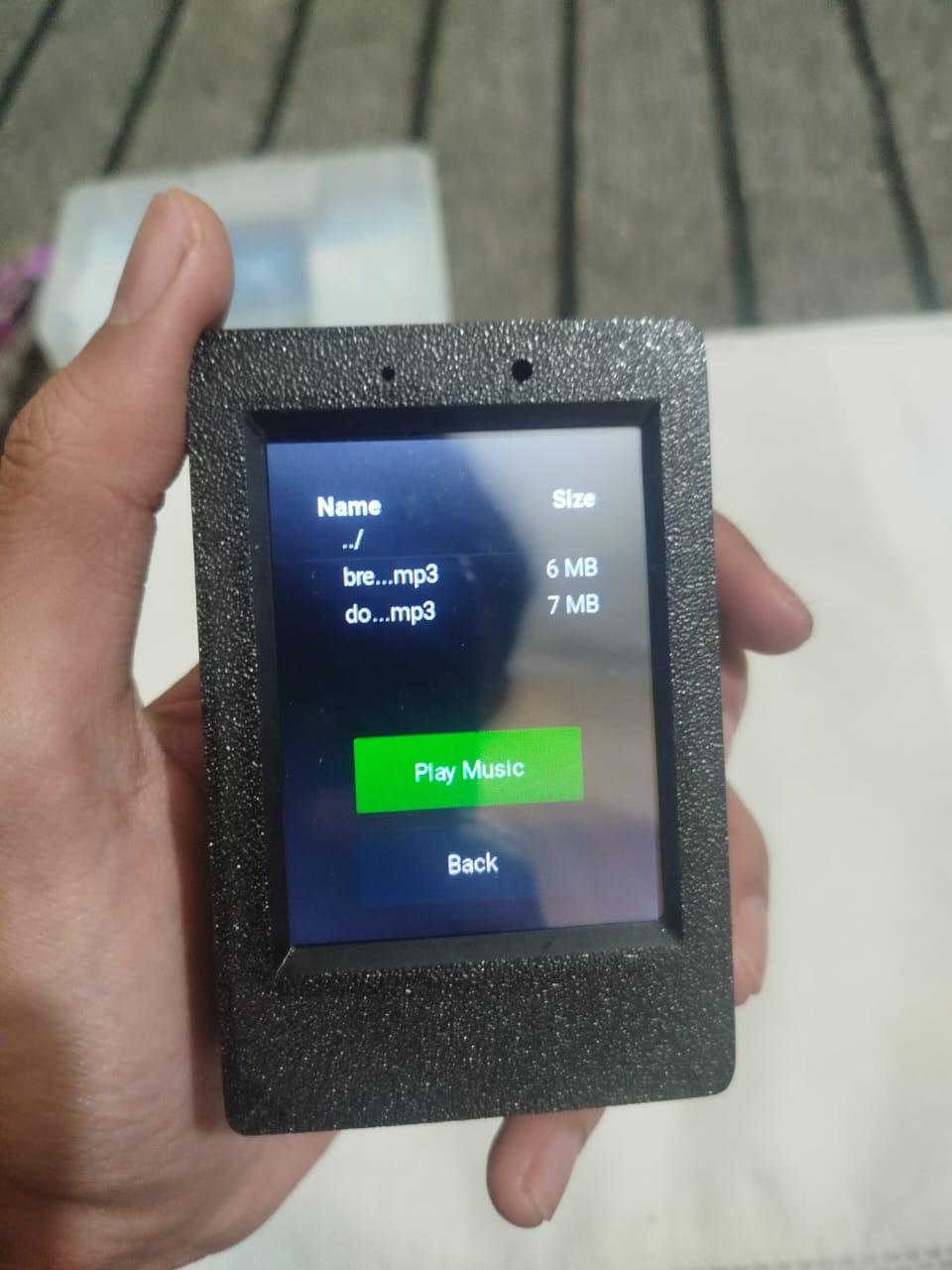

Third screen, It is the screen where we can select the music and Play it. We can select the music available in folder.
