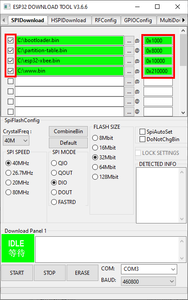

- Flash the XBEE ESP32 Firmware Note: Your COM device location will be different than mine. You’ll need to identify it first before continuing.
- Windows
- Open the ESP Flash Download Tool, select the firmware files, set flashing options, and click “Start” to flash the firmware onto the ESP32.
- Loading ESP32 Firmware on Windows - github.com/nebkat/esp32-xbee/
- It is important that the offsets exactly match the files:
- bootloader.bin @ 0x1000
- partition-table.bin @ 0x8000
- esp32-xbee.bin @ 0x10000
- www.bin @ 0x210000
- If you would like to reset the device configuration, you should also include:
- wipe_config.bin @ 0x0
- Flashing ESP32 Firmware on Windows - github.com/nebkat/esp32-xbee/
