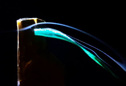

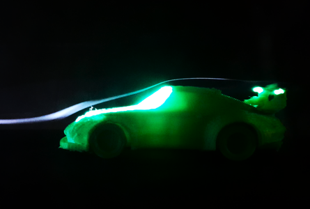

Step 6: Models
Use 3d printed cars or bent plastic as models
Step 7: Pictures
Thats it!
Adjust speed of the wind and take pictures of the items.
