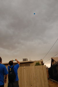

I was worried that the afternoon storms had whipped up some wind, but we got a little calm, so i decided to go for it.
I was worried that the wind might catch the balloon as i was filling it or tying it, so i had friends hold a netting over me. while I inflated it. It was a good idea. made the act of tying a knot and getting it on the string much less stressful
It had more lift than i thought. (was not totally full probably only 80% of the way to being frighteningly full)
Slid the platform on the bottom of the balloon, and turned on the camera. (note to all of you out there, apparently i bumped the button so it recorded one second. :( but after letting it up and reeling it back, i found that out so we launched again, this time being sure it stayed recording. ! Woo! two for the price of one! )

When we were all done I retrieved the camera from the platform, taped the platform to the balloon, and set it free! It was visible for about 11 minutes until it started to kiss the clouds. Lets hope someone mails back the postcard! if so i will scan it and post it here!
