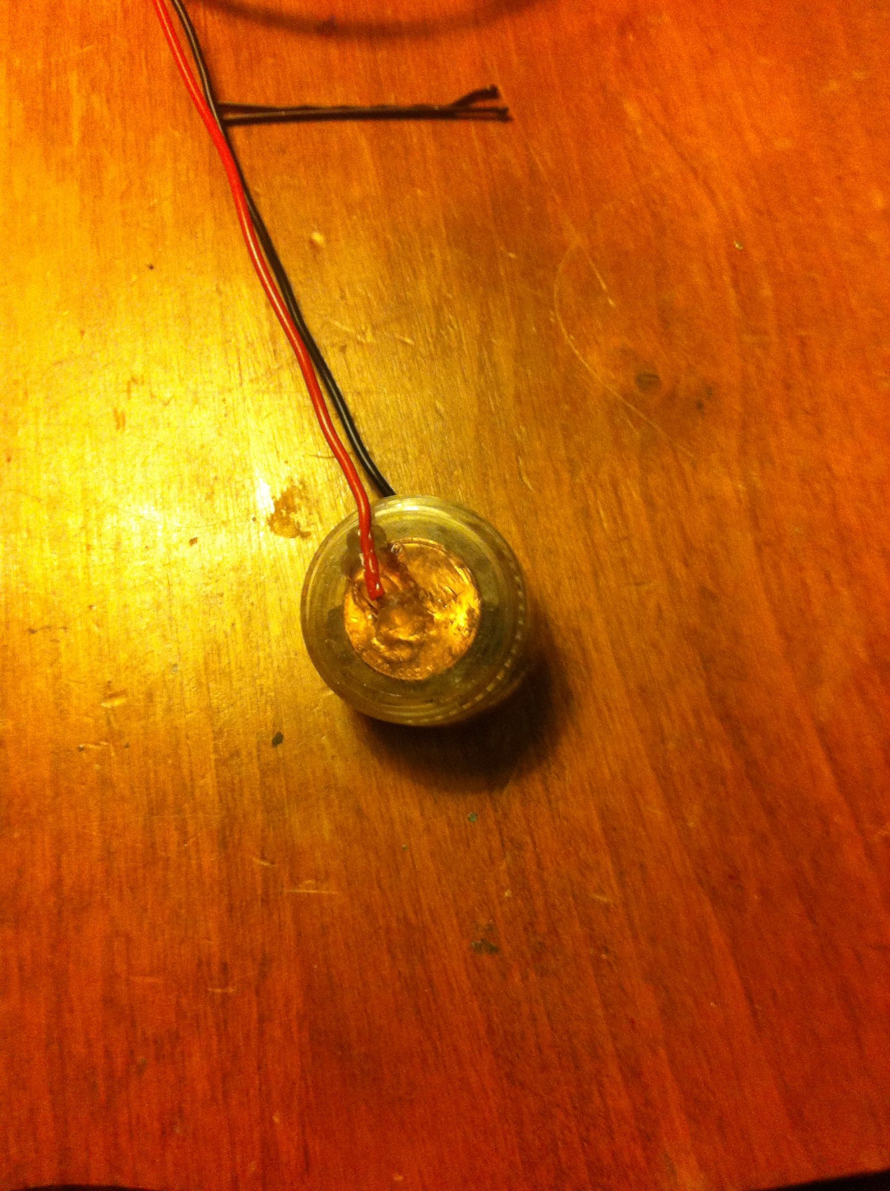

Step 5: Sturdy Rear Wheel on Axle
I had used a cardboard fin to start(bad idea), it was very picky on what surface it would work on. The fin finally collapsed in, but I had recently scrapped the wheels from an old toy, so I hot glued them on for added traction/support. This would be the step I recommend to use your imagination on.
