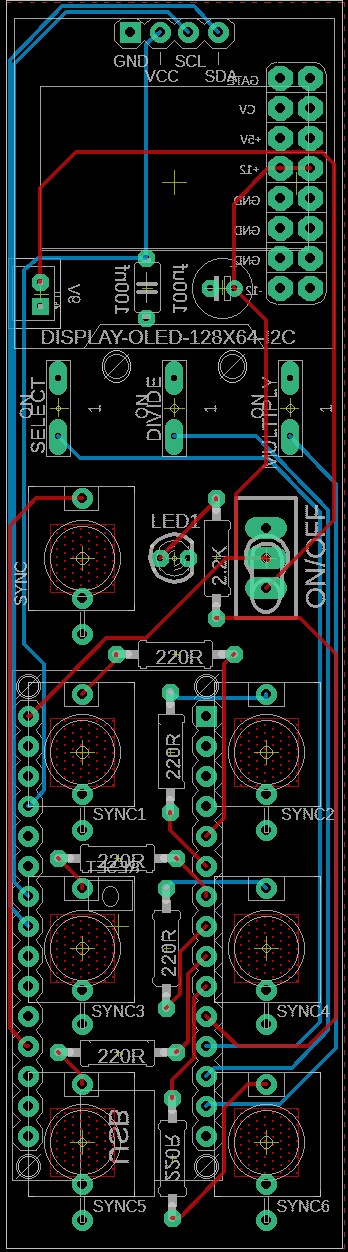

Step 1: PCB & Front Panel
We all have different levels of knowledge, so when it comes to a build like this I want to make sure that I'm providing enough information so anyone with some basic soldering skills can make it. That includes ensuring there are instructions on how to get your own PCB's printed (which is super easy!)
So with that said, the first thing you will need to do is to get the front panel and PCB printed. I use JLCPCB (not affiliated) to get this done. The front panel is actually just a PCB without any components included! The front design is done in a program called Inkscape (available free) and the panel including the drilled holes is done in Fusion 360 (also free!)

Step 2: Adding Components to the PCB - Part 1
The PCB is 2 sided with the Arduino and caps being soldered on the reverse side.
STEPS:
  1. The first thing to do is to solder the resistors to the PCB.
  2. Now you can solder into place the JST connector. This is how I power muy modules. I have also included a 16 Pin Eurorack connector which you can use to power the synth via 12V
  3. At this stage it’s best to flip the board over and add the Arduino. If you don’t and add the rest of the components, you’ll find it tricky to add the Arduino later.
Step 3: Adding the Arduino to the PCB
Next step is to add the Arduino to the PCB. There is a way to do this that ensures it fits perfectly each time.
STEPS:
  1. First, add the header pins to the pins on the Arduino.
  2. Now, put the header pins into the PCB and add some solder to the corner legs to hold it into place. Make sure that the rest of the header pins are sitting correctly in the PCB.
  3. Now you can solder the rest of the pins to the PCB.
  4. Remove the Arduino once done so you can get at the legs of the components that need to be soldered on next
  5. Oh, and you may as well solder into place the 2 capacitors on the reverse side
Step 4: Adding Components to the PCB - Part 2
Now it’s time to add the rest of the components.
STEPS:
  1. Solder the audio 3.5 connectors into place – all 7 of them
  2. Now do the momentary switches and the toggle switch
  3. The last thing to solder is the OLED screen. Add a female header pin to the PCB and the solder into place 4 X male header pin to the OLED.
  4. Remove the little plastic spacer on the 4 X male header pin and trim each leg about the same height as the spacer.
  5. Now push the OLED into place. It should now be the exact right height to go flush onto the front panel.
